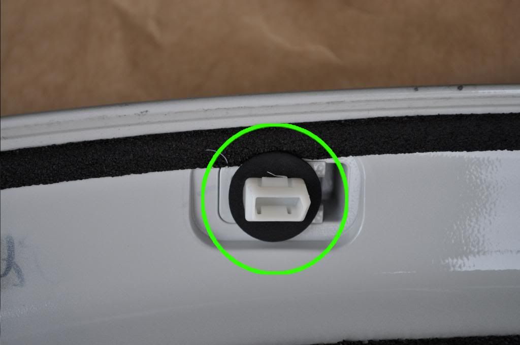

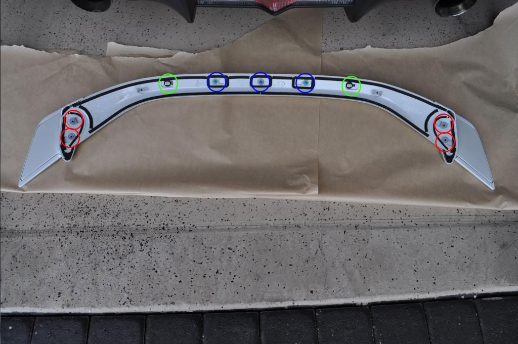

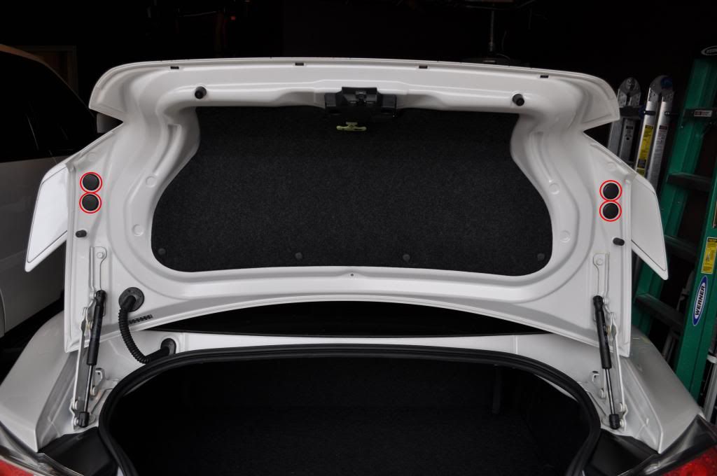

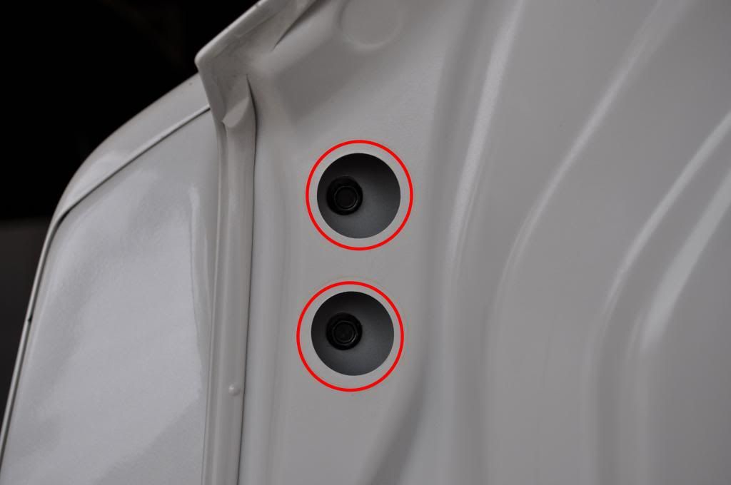

Ok here are the pics and measurements that i took when i had my spoiler off today. Im not that great at DIY write ups but I hope this helps you out.
First pic just shows the 2 rubber plugs on each side that cover the screws and the next two pics show it with the plugs removed.
Here is the underside of the spoiler with the push pins. You mentioned you only have three which im assuming are the three circled in blue. There are two more that are different from the other three which I circled in green.
Here are the measurements of the holes for the push pins in the middle. They are measured to the center of the holes. For the outer holes where the screws go it was kinda hard to get spot to go off of so i would recommend doing the ones shown here first and then with the spoiler in place mark the outer holes.

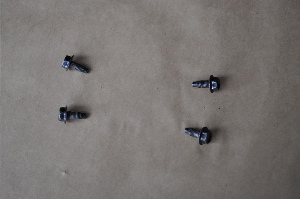

Here are the 4 screws used on the outer holes. Not sure what thread type it is but its a 8mm head.
Area86 is offline   Reply With Quote
Thanks Area86 ! I have tape on the way already so maybe I'll combine the bolting and taping lol. Very secure spoiler install incoming... I'll do my best to document the process and post a DIY for those in need.
Thanks for the excellent detail on measuring the push-pin holes. I can figure out the thread of the bolts by being the awkward asshole in Home Depot with a spoiler in his hand testing every bolt lol.
Just to be absolutely sure, when you measured the 1 1/8 inch to the holes, that was with tape measure laying flush with the curve of the trunk?

Yes it was flush on the curve and that's to the center of the hole as well. Good luck with the install and let us know how it goes.
