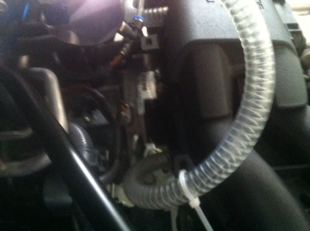

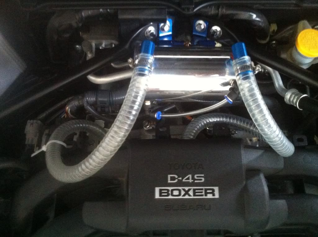

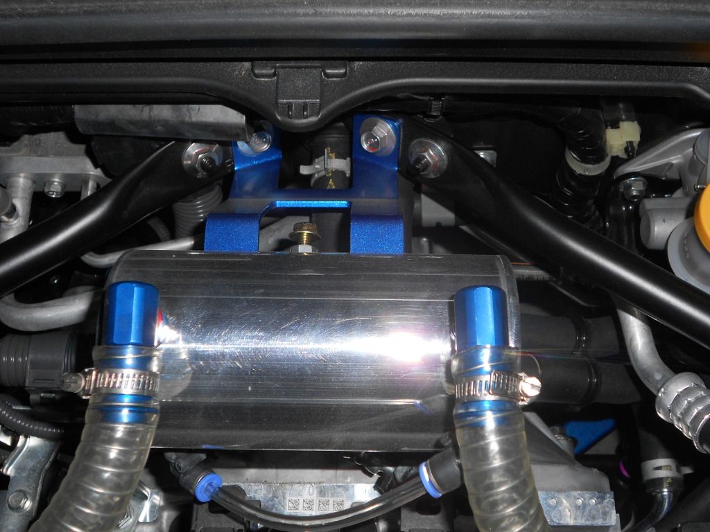

Here are some pics as requested:
The can
Driver's side
Passenger side
Hope that helps!
