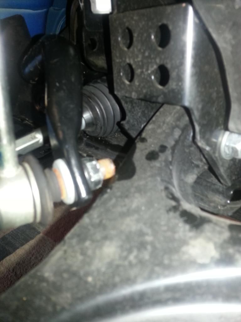

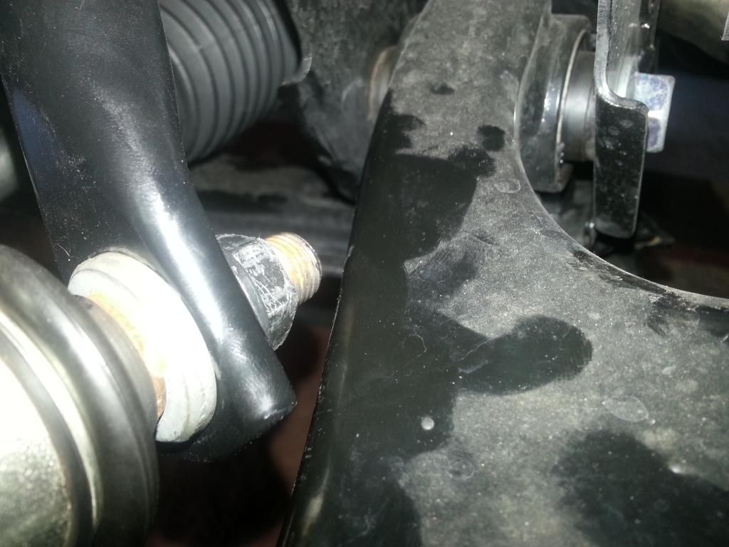

Make sure Strano bar is centered before you connect up the lower endlink nuts. Too far to one side will make the endlink bolt hit the control arm under compression. Put a jack under each control arm and move suspension through full range of motion to make sure you have clearance on both sides.

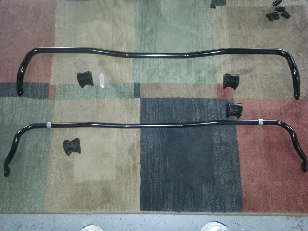

Strano bar on top...
Bar not centered correctly...
After centering...
