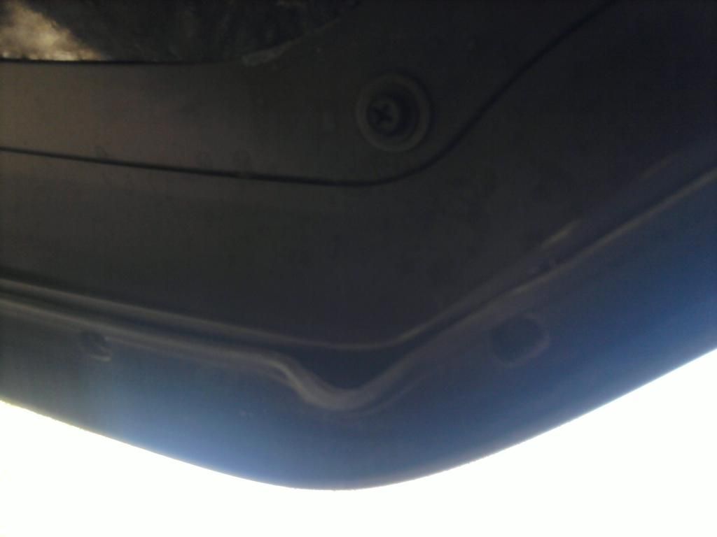

So after cleaning and preping the bottom of the under spoiler I removed the double sided tape cover a section at a time while pressing it to the under spoiler. First prob I encountered was the two points on the spoiler caused the skirt not to lay flat and made humps.

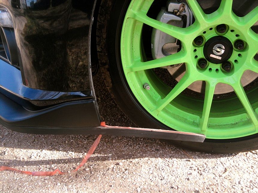

So i took a razor and cut small pieces out of the hump to get that part of the skirt to lay flat. After I got the skirt situated I used a razor again to cut off the excess length of the skirt

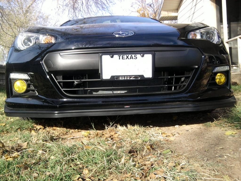

I chose not to drill any holes in the under spoiler since it cost me almost $700 and I didn't want to take a chance of damaging it. So here is a look at what i ended up with
