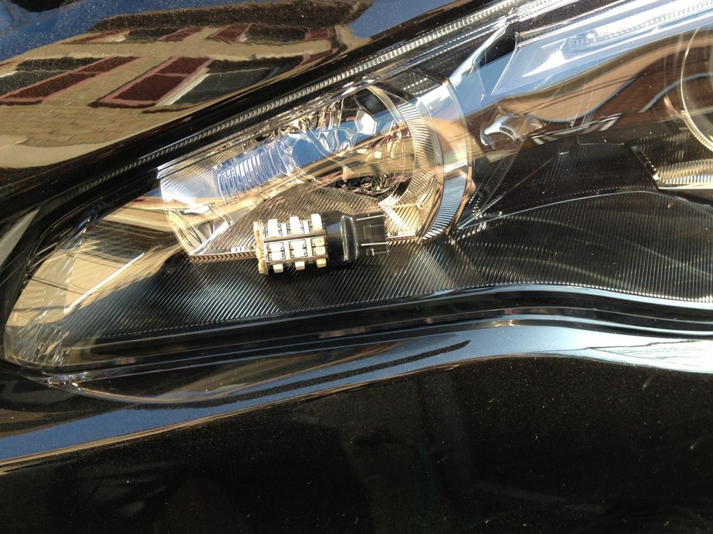

Can anyone recommend a set of stealth bulbs for the turn signals (front and rear) that actually fit and click in place?
I went the LED route and they fall right out. Even worse, I tried to use a hanger to fish it out and put a little hairline scratch on the lighting lens. So I had to quickly run up to AutoZone and buy a magnet. Anyways, beware these LEDs are NOT a direct replacement.

you should get 7443 bulbs for the front or you lose the parking light function. this post helped me out a bit: http://www.ft86club.com/forums/showp...7&postcount=18.
you can see the difference too here (7440 left, 7443 right):

I'm using chrome bulbs also but I have to ask - are you sure you had the bulbs fully clicked in? Even non-LEDs will require some force to snap into place. I have not read about anyone else with LED replacements having theirs fall out.

Yeah, they wouldn't click in and they wouldn't sit fully in the socket. They wanted to bounce right out practically. I'm not going to say any names but I'm shocked they would sell this garbage to anyone. Bought as a direct fit for a BRZ. The rears seemed to fit a little easier but you had to be super careful with them or the bulb would come off the prong connection. Essentially it just wasn't a direct fit. It rings cheap China made that generally fits on some applications. I'll try and find the manufacturer out. The funny thing is I've always used the stealth bulbs but this time I thought I'd try the LED thing. Oh well, just a waste of time and time is money.
