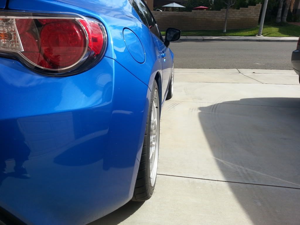

18X8 +35 with 225/40/18 Pilot Super Sports. I'll get some better pics soon.

Prayer answered!!!! How much drop do you have? Car looks amazing!

Thanks. The car is dropped 1.25" I believe.

Those are really nice!

I have never liked this wheel but for some reason it just works on this car, looks good.

The looks GREAT! Please detail the cost of doing this. I suppose it's wheels, tires, and drop costs? Where is the best place to get all the parts? VERY nice job, sir.

a good look. what are you dropped on?

springs? coil overs?

I have always hated this wheel, but after seeing this im going to seriously consider them... that looks really good.

KW V3's can be found for under 2k shipped. The wheels were about 1k. Tires were under 900 shipped from Tire Rack. I also had to get a set of cusco rear arms to fix the massive amount of camber (almost -3) after the drop. And you will need an alignment obviously.

KW V3's.

Lol honestly I was never a fan of these wheels either but after seeing a photoshop of these on here I decided to go for it.

this!! damn near perfect, thanks for sharing!
