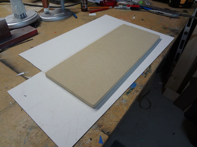

First, cut the MDF to 6.5" x 16". Same with the foam (using the MDF as the template). Sand the MDF on all sides and lightly round all the corners to avoid sharp edges.

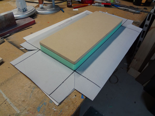

Lay the foam and then the MDF on top of a vinyl, with the black face down. The vinyl has a white fabric backing. Mark the outline of the foam/MDF with a marker so you will know where to cut the corners.
Now, cut the corners as shown. You can then gather a corner inside out and sew from the corner down about 1 1/2" (or the height of the combined foam and MDF). After sewing all four corners, turn the vinyl inside out and put it black side down. Now insert the foam followed by the MDF.

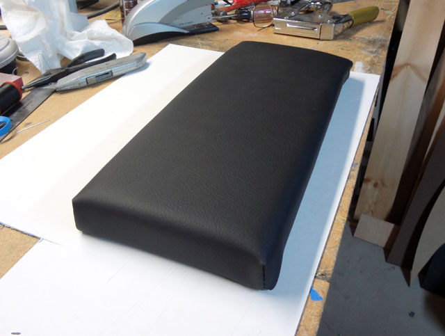

Here is what it looks like from the top:

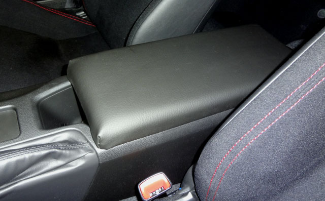

Here is how it looks sitting in the car.

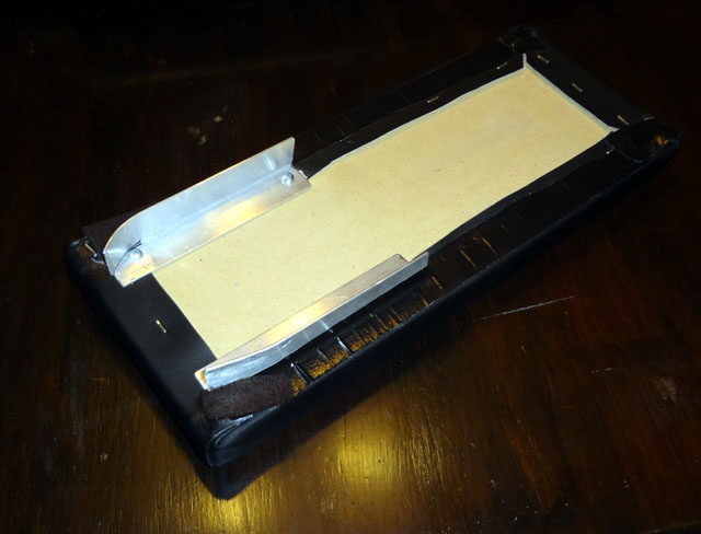

I came up with a method to have the armrest slide open to access the contents. I made two tracks out of 90 degree angle aluminum and mounted them on the bottom as shown below. I had to curve the ends so they would slide up to the curved section of the opening.

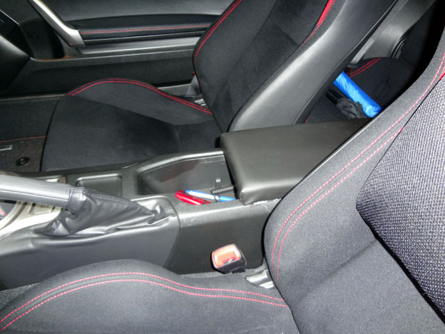

Here is a picture of the armrest in the open position:
It is not secured with anything so it can be removed easily.

I finally did come up with a way to mount the armrest so it slides open for limited access to the contents. See the original post for some new photos. Basically, I mounted two 90 degree angle aluminum pieces top the bottom. They are curved to match the curve in the opening so the armrest slides all the way forward in the closed position. I don't use the cup holders so that wasn't a priority to keep them with this method. It is also not permanently secured as I didn't want to make any holes until I see what the OEM armrest will look like.
