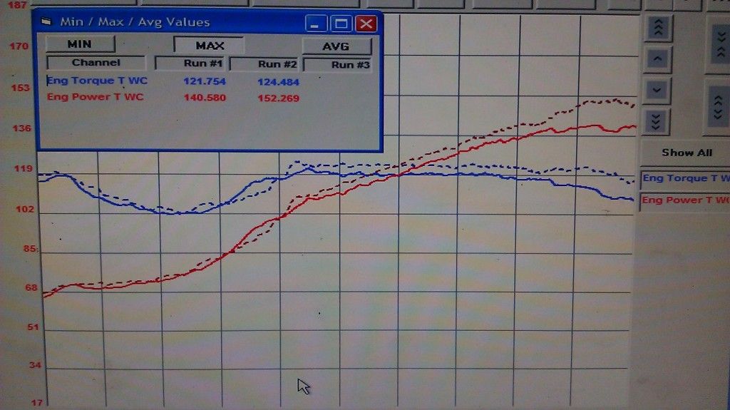

FA20CLUB.com Stage 1 ECUTEK Reflash Results
Put a kick in the pants for your new daily.....FA20 Club is proud
to release our much anticipated Stage 1 Reflash. This flash develops an increase in TQ and HP throughout the entire powerband. Your vehicle will now be more of what you expected when you signed the papers at the dealership. Some of the features we have enchanced in this tune include:
Increased TQ Limits
Adjusted overall AFR Mixture
Optimized Timing
Optimized Cam Angles
Added 2Step Launch Control
Increased REV Limit
Speed Governor Removed
DTCs for Common Check Lights Removed
With just these minor adjustments to your ecu you are able to gain power without sacrificing the integrity of the original product you purchased. Not to mention the nice over peak gains of 10-13whp. Even on AT transmissions. With purchase of the retail cable we will provide updates to the original purchaser.
FYI: Mustang Dyno numbers are typically 10-11% lower than DynoJet numbers. So our baseline on the A/T FRS would be roughly 154HP to a typical gain of 167HP for comparison to other available products.

Does this tune make the torque dip even worse or is it just me?

Looks like the torque dip widened.... :/

Actually the dip was lessened and it motor also recover from the power loss earlier in the run to the high values. There was only one area in the entire dip that the values were reversed and i found it was related more to the TQ limit table. But since its an A/T i wont want to increase the limits that much on the low end where the transmission shifts without some more testing on the actual affects to the shifting as far as smoothness is concerned. On a manual i dont see that happening since with some spirited driving the shift points would vary more towards the upper end of the spectrum anyway.
