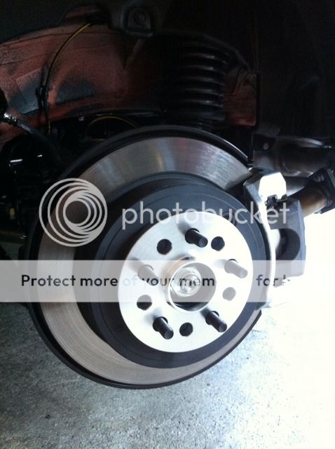

I recently changed out all of my studs and added spacers.... ill take some pics tomorrow.

Thanks: 141
Thanked 290 Times in 56 Posts
:happy0180:

Originally Posted by frs86.tea View Post
:happy0180:
What size spacers are these? Is it hard to install?
