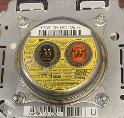

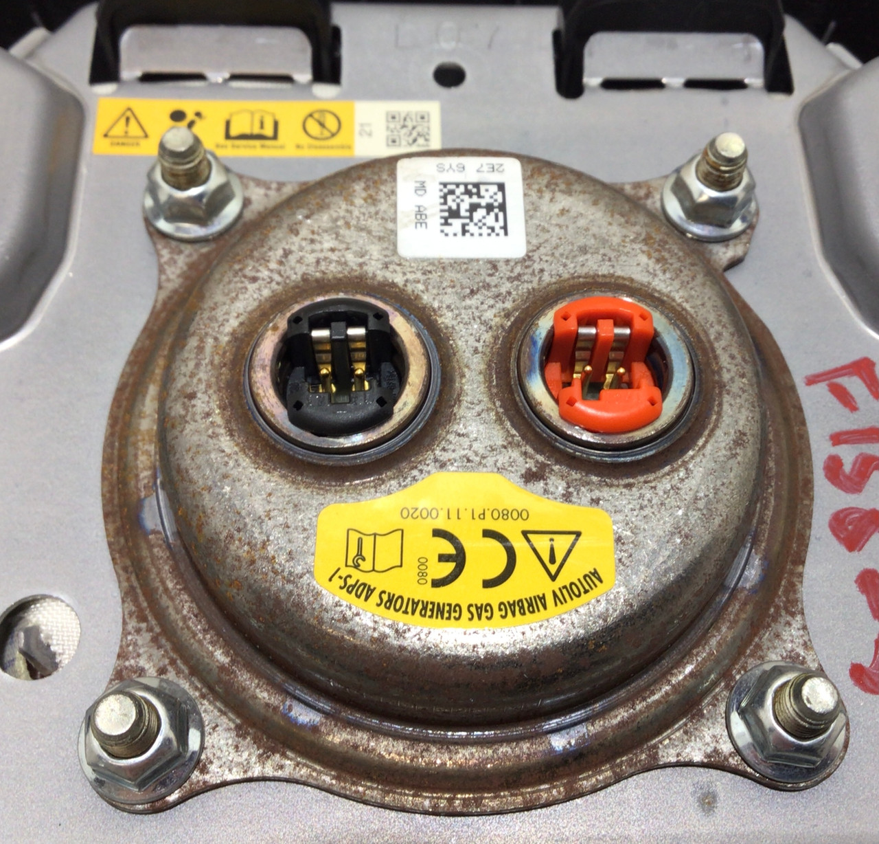

On the airbag canisters the conectors look the same but the labels are different so they may be compatible. Hopefully someone more knowelgable than me can weigh in on this. I don't think that you can buy just the cover from the dealer so it may be easier just to buy the whole airbag assembly.

Thanks for the information, mate! I found some airbag covers online for the 2017-2019 BRZ/86, which means I can give it a try.
