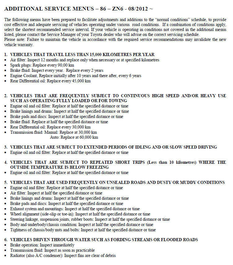

Few people been asking about what oil to run so thought this might help.
A thin 5w-30 GL5 would be alright if its proper hot were you live but 0w-20 is the preferred grade. (If I was heading to the track then Motul 300V 0w-20 would be my choice)
Manual trans; you could run Motul Gear300 although some people have complained of hard cold shifting but if you're track bound then it's worth putting up with
Auto; Toyota-WS or Motul ATF VI.
With the Torsen LSD I'd be inclined to run some a bit thicker than the spec'd 75w-85 especially if you're going to see track time. I find the thicker oil helps the Torsen hook up better. Again you can't go wrong with any 75w-85, 75w-90 or 75w-140 from the high end brands like Redline, Amsoil & Motul etc

It says right there "operating under normal conditions only". So if you drive in -10 degree Celsius is that normal? How about tracking. The car was designed to fit 4 wheels in the back. What about +45 degrees? I am suggesting that different grade oil may still be applicable depending on use.
It also says "Use only genuine Toyota Dot 3 Brake Fluid". Seriously, who in their right mind is going to replace their brake fluid with Dot 3?

Captain Snooze this should answer a few of your questions.
Yes the torsen LSD is gear driven, the 140 weight works like shimming a plate type. It just keeps it engaged better I find. If you look at the TRD catalogue they only supply 80w-140 for FR LSD & IS-F service schedule recommends its use on the track with their Torsen LSD.
I'm surprised the additional service specs doesn't go into more detail for track use considering the amount the designers have gone on about it being a perfect track day car.
