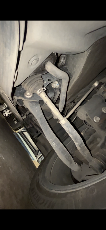

I see what you mean now.
Yea I don’t understand, it’s very situational. It had always happened occasionally since I got the wheels on the same high angle right turns, but then got worse than ever after pumping the tyres back up to 36 PSI. Now a week later it seems to have become less frequent again but still there if I’m accelerating from a stop at close to full lock, or braking as I turn right close to full lock.
There’s a picture from the front of the assembly, dirty but I can’t see any marks from where the wheel/ rubber would have grinded on anything.
I’m about to install springs, possibly camber bolts and have an alignment so hopefully after all that the sounds good away
Sam86 is offline   Reply With Quote
