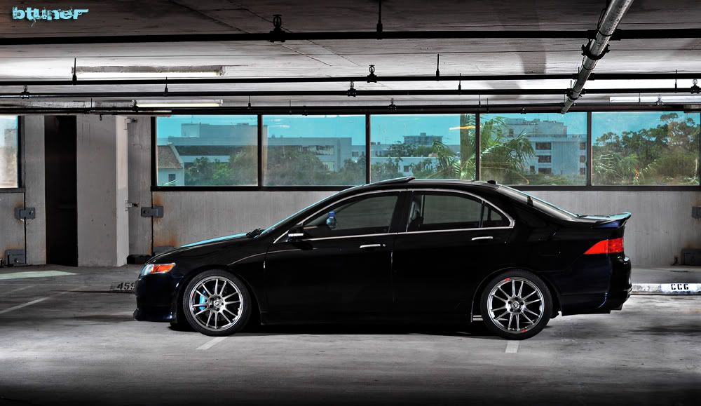

Wheel experts - which will fit better?
SLIGHT difference - BUT
Which one will be the better fit out of these (Going for the more fitted look and aggressive spokes)
Enkei GTC01 18x8 +48 (in the picture, leaning towards getting these)
OR
Enkei GTC01 18x8 +35
OR
Enkei GTC01 18x7.5 +48
going all round same width, don't want it staggered
Some visuals from le google

Personally I'd go for +48 18x8.
I'm going that route with Ultraleggeras - they'll be near flush at the front with a slight (20mm) drop, not too far inboard at the rear, keeps the unsprung weight near where it was originally, and 8" gives me the ability to have tyres I want "stand up" a little more.
