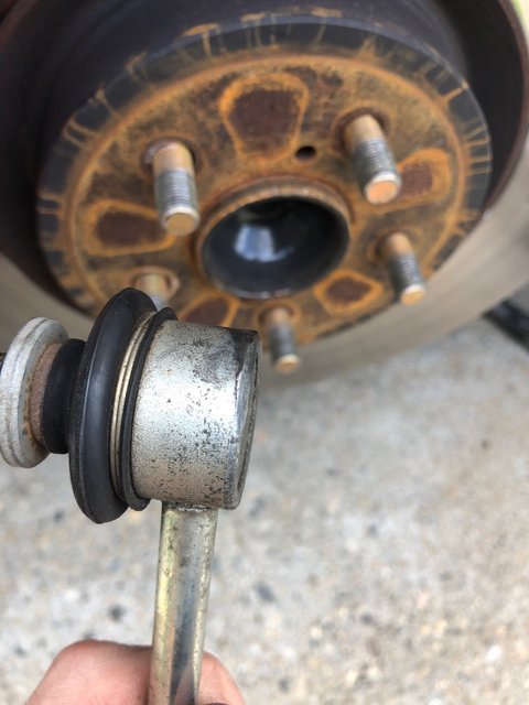

I get it on my 2019 fairly frequently, it still will steer, just need to use some force. I had rubbing issues from my coil perches and end links rubbing the chassis, but no rub issues with my coilovers now. Still getting EPS shut off.

I am assuming you meant endlinks and not tie rods. Which one's are you running? I had a lot of issues until I went with the whitelines. I notice the thickness of the rod end was much narrower than others I had tried and they no longer hit. This is with -3.6 front camber though I have maxed camber at the knuckle before adjusting the top hats. I am probably going to -4 next year so that could change.
Hahaha yes, thank you. Completely stock suspension SACH dampers, TRD Springs, TRD sway bars. I too was looking for slimmer end links, but ended up getting coilovers and that solved all my rubbing problems. I am at -4 up front with a single camber bolt and 95% maxed out camber plates.

A lot of aftermarket stuff poorly accounts for other aftermarket stuff and stuff can bind. Remember the joke "Interchangeable parts don't."
End Links are a great example - some folks have put steering rack limiters so that they can't turn too sharply in the paddocks because it would break their end links. I'm thankful that my strut+end link choice didn't create that scenario for me.
