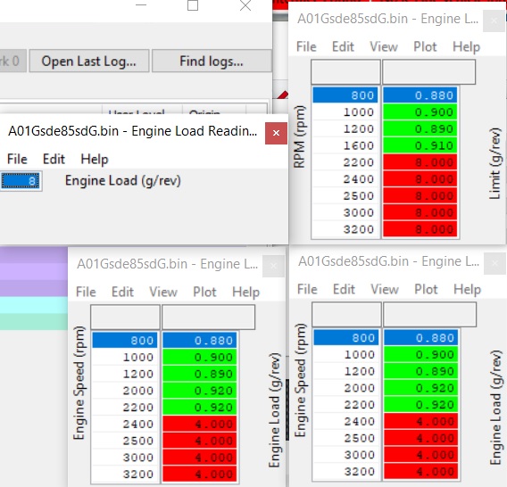

Old 07-26-2020, 04:36 PM   #8
solidsnake11
Join Date: Nov 2018
Drives: brz
Location: nc
Posts: 318
Thanks: 431
Thanked 739 Times in 443 Posts
Originally Posted by Kodename47 View Post
All 3 load limit tables changed?
I hope there is another load table but I haven't found it.
solidsnake11 is offline   Reply With Quote
Attachment 190676
2 of the tables are showing max 4?
Yes the top right is supposed to replace them from my understanding.
Ecutek says "Replaces OEM load limit maps to allow limit > 4"
