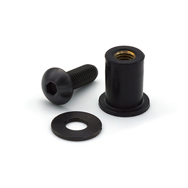

I have run over a few things on the street, but I never had it hit my Fumoto drain, luckily. I love that drain plug. It would take a serious event for me to switch back. Even then, odd things happen, which means it is less likely to happen in the future, statistically. Internet stories aren't enough to scare me. If I did based on a few people's unlucky experiences then I probably never would have gone forced induction on a stock motor.
I don't really see much difference between having this on the street and having it on the track. Like perhaps there is an argument that track speeds are higher, so there is less time to avoid an object on the track compared to the street, but the street has pot holes, more debris and most traffic obstructing the view of the road.
With that said, if I was slammed instead of just lowered by an inch, and if I was driving in conditions that had lots of pot holes and debris, then I would consider making a plate to block the hole that I could remove during oil changes. One solution is to use well nuts (rubber, screw rivets): drill some holes in the stock skid plate; place the rivets; cover the hole with a piece of aluminum plate that has bolt holes that align with the rivets; screw in the plate; rivets expand to stay secure. That is just a super simple and cheap solution.
