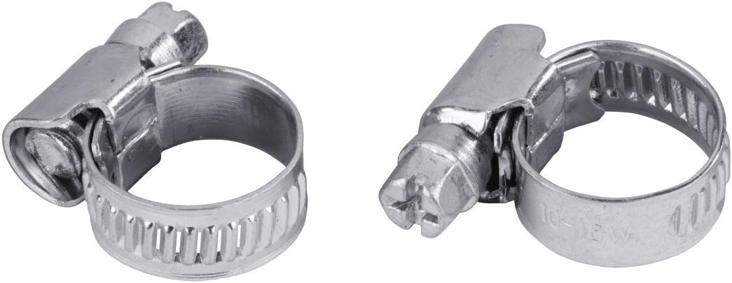

They're not flared on the outer edge, but have a higher diameter "ring" on the inner side that sits on the rubber hangers which you can sort of see on the picture above. Having that on all four corners would very much negate the risk of it sliding off, as it prevents the metal from sliding too far into the hanger.
I was thinking of using a screw collar to bring that risk down to 0:
alex87f is offline   Reply With Quote
I missed that.
The small hole clamps work great as a temp fix, that's how I held my Greddy on until the new hangers showed.
