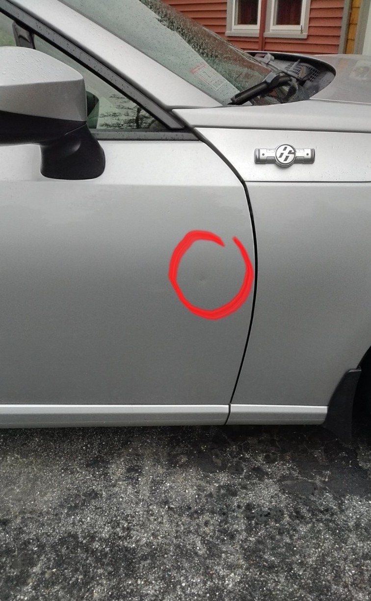

So, despite parking away from people as much as realistically possible, occasionally I come out of stores and find someone squeezed right up next to me... I manag d to collect the ding below a few days ago, and only noticed after I got home.
It's at a spot where its visible from just about ever angle, so I want to try working it out from inside the door. But I have yet to take the door panels off this car, and I'm curious if the location shown is easily accessible with the panel off...? Anyone have a picture to share of the bare door?

C'mon guys...don't you think I already considered paying a PDR guy? I want to do this myself...just want to know what's under the door panel before I get there..

venturaII: I've taken of the door panel to muffle the rattle noise from the window switches rattling because the music was too loud. You should be able to get to that spot with minimal issue, but there's some plastic sheeting behind the panel that you might have to cut or carefully move.

Access to that spot is is super easy. Only thing in way is the speaker, and the window mechanics.
Come on dude 3 seconds of google-fu you could have found pics.

However if you wish to tackle this then here are the disassembly instructions. Of course you would not have to do all of it to access that dent though.
https://demos.starbase7.net/t3Portal...35217316511084
Bingo! Clip locations and everything! Thanks!

You can get there with just taking off the door panel.
