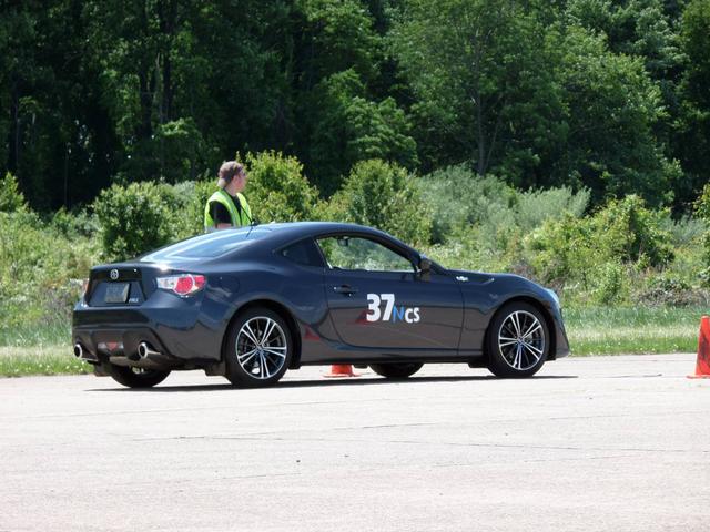

The car saw its first autocross at 800 miles.
I instantly became hooked on it. Ive autocrossed for a few years prior to autocrossing my FRS, but something about the FRS made me want more.
I started doing heavy research into tires, alignments, shocks, sway bars, and class allowances.

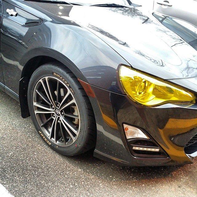

By the next event (maybe 1200 miles on car) I had brand new Dunlop Direzza z2 star specs, an eibach front sway bar, and TRD springs on the stock dampers.
I finished the rest of the 2014 and 2015 seasons with a far from stellar performance, but I had a lot of seat time.

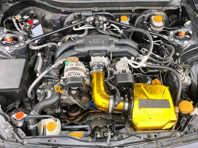

With the announcement of the new class SSC, and the news that the twins in DS will soon become obsolete with the addition of all boost buggies from BS, I decided to start an STX build. At first I simply had the intention to do wheels, suspension, exhaust and tune. Nothing "extra".……..

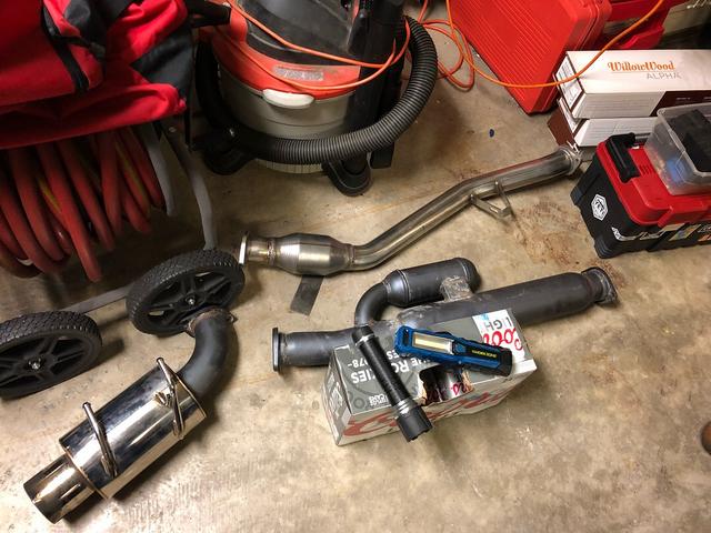

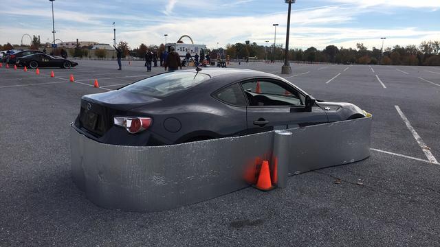

I installed a Tomei UEL Header, Tanabe OP, Berk Catted FP, and an HKS catback (its loud).

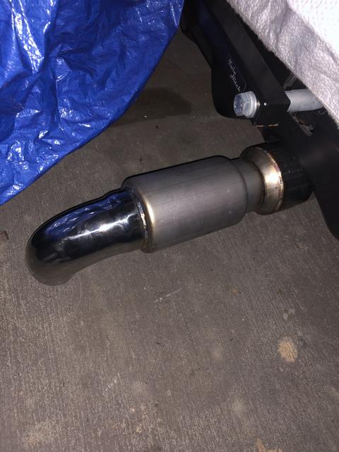

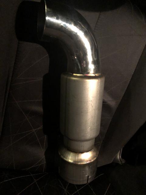

So loud, in fact, I had to come up with something to not go over the sound limit at national events.....
Allow me to introduce the shin destroyer!
Its just a 90 degree bend stuffed with steel wool.
Im working on a new one for this season...

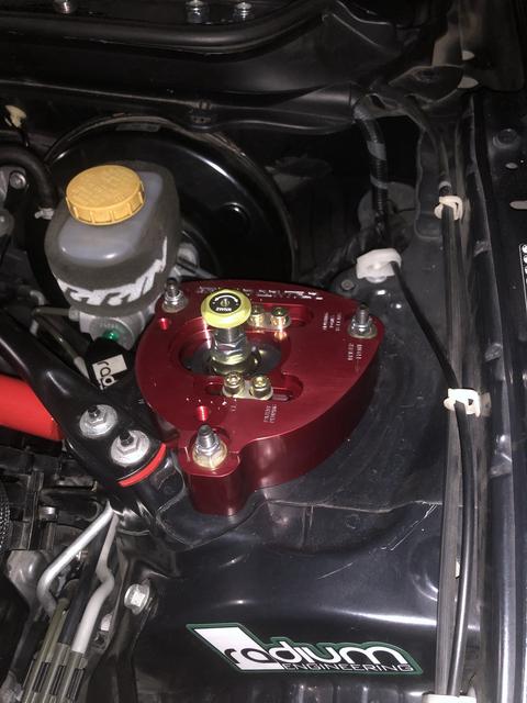

I brought it to a reputable local race shop to install / convert my coilovers from street class to STX spec, and to install my Raceseng crank pulley.
First, the race seng cam cas plates were not jiving with my MCS. After a few phone calls to him we got it sorted and they were functional. I was running 450# square springs.

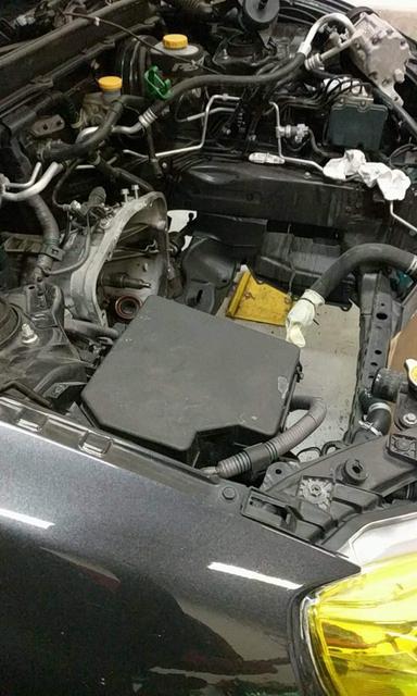

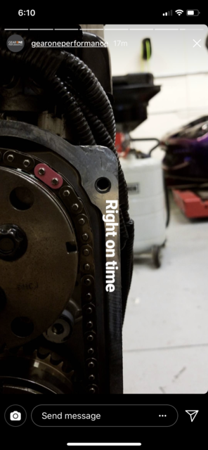

Moving on, I knew that after 4 years of basically 200 autocross runs per year that my clutch wouldn't be in the best shape, but I didn't have any TOB noise, and from what I could tell it wasn't slipping.
The shop attempted to install the crank pulley and first things first, with the car in gear and the parking break on, when they attempted to loosen the bolt the engine was turning. FFFFFF
They took the starter off and was able to hold the flywheel some how, but the stock pulley damaged the key way, and the threads for the bolt. So between that, and finding that the clutch was slipping, I decided to go all out on this build.

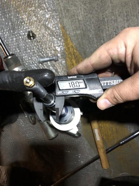

I ordered Whiteline steering rack bushings, trans mount insert, differential and carrier inserts, and rear subframe inserts. Followed by perrin motor mounts, Verus rear lower control arms, mann engineering rear sway bar, and SPL rear endlinks.
So yea. I wanted to build a semi all out STX build. I figured if they were pulling the engine they might as well put a bunch of other stuff in there.

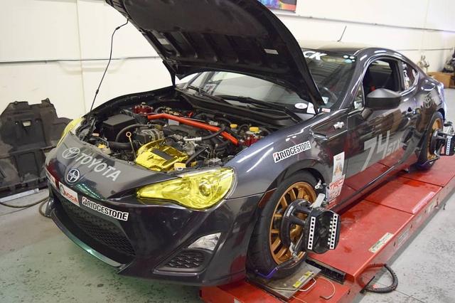

The season started well, I was paxing pretty good locally, but the car was very very loose.

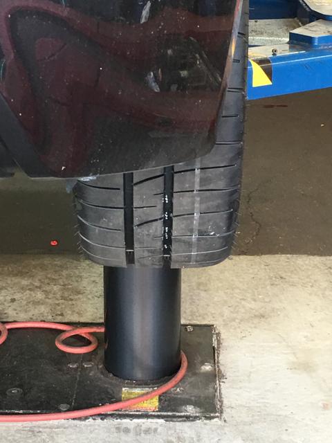

Before the season went full throttle (see what I did there) I got another alignment to dial in a little rear toe (1/8").

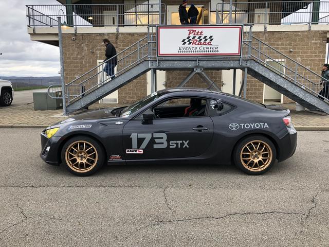

First big event of the season, the Pittsburgh Match Tour.
Day 1 I did not do well. Like I said, I have been chasing down this oversteer issue. I think I got 4th in STX?
Day 2. I qualified for the Top Dog Challenge. Surprisingly I won. I know the TD challenge is more about consistency rather than raw timing so I guess I can say I am consistently slow? What ever. Pictures below

Fun Fact. My exhaust set up is so loud that even with the turn down, the car next to me was not able to hear his engine when I am on the 2 step.

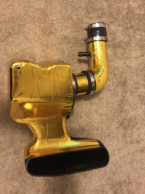

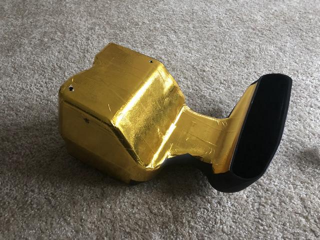

Fun with Gold tape.

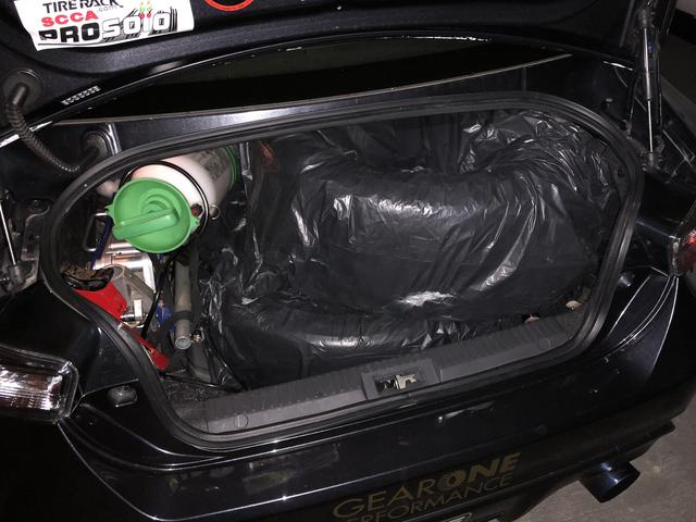

Gearing up to drive from Philadelphia PA to Lincoln Nebraska. I didn't have much time to take off from work so I had to skip the Pro Solo Finale. Also, Since I was late to sign up for the EVO school, the only slot I could get into was Sunday at 8 AM. That means I had to leave work around 4pm on Friday and drive 1400 miles to Lincoln, get some sleep Saturday night and practice on Sunday.
I packed the car up to the brim. I put the stock wheels and tires on the car, took out the spare, I was able to fit 2 wheels in the trunk, my sprayer, my Jack, and 2 Jack stands. 2 more wheels went in the back seat along with my tool box, my plastic container, and a Jegs fuel can filled with local 93 that the car was tuned for (I heard 93 is hard to come bye out west). I had my clothing bag and some other stuff in the front seat. The car was insanely packed.

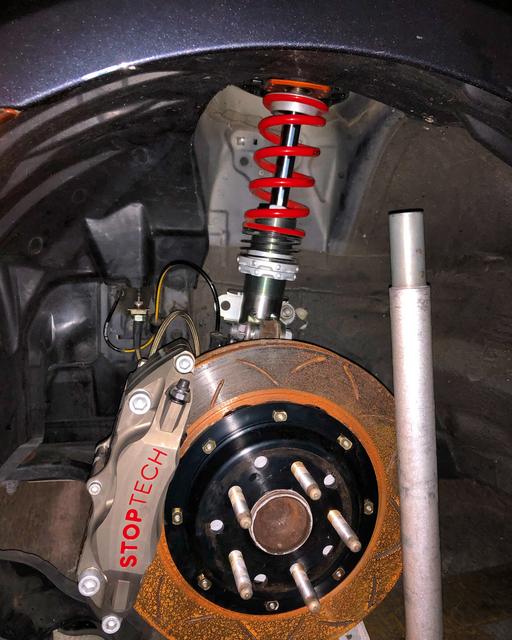

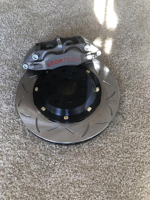

The car was sitting peacefully in my garage. All it truly needed was some new tires and an alignment for the 2019 season. I decided that was too easy and I wanted to ruin it some more.
A few quick calls and I was able to score the new Stoptech st30 kit.
Just one issue with this kit. The directions were not very clear. The bleeder valves come with the kit on the wrong side of the caliper, and for the twins you need to swap it to the other side. This was not mentioned anywhere. So I installed the kit with the bleeders up. The pistons are not the same size and the caliper is meant to be run in the orientation it comes in if that makes sense. So after realizing this I had to uninstall the calipers and swap the bleeders and swap the caliper side to side. I did this and it wasn't an issue. I used a power bleeder so it was easy.

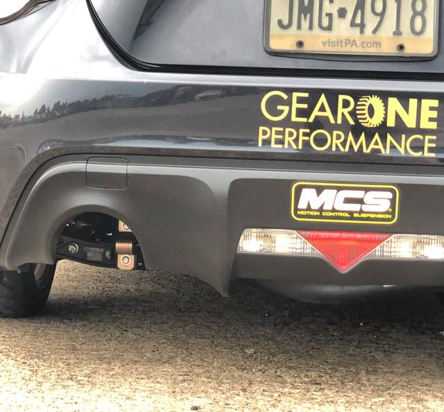

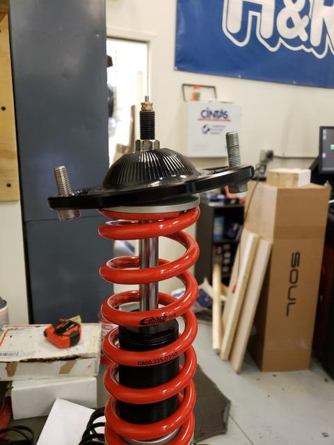

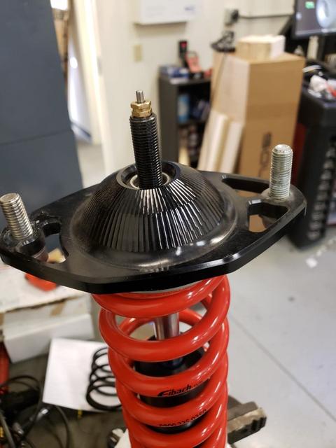

Fast forward to January. My current set of MCS have about 15k miles and 3 years worth of autocross so I was debating sending them in and getting them rebuilt, but I decided against that and simply purchased new MCS 2 way non remotes for the front only.

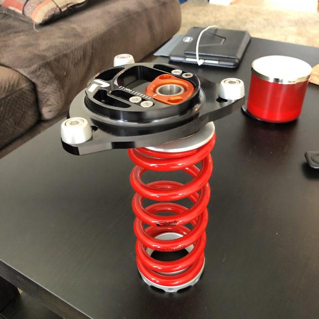

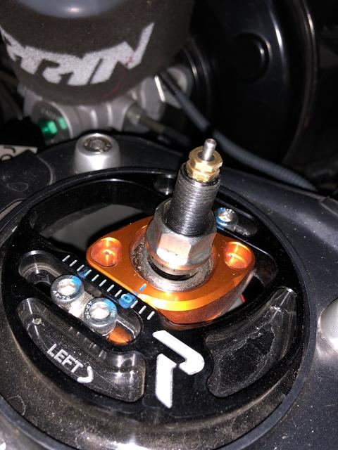

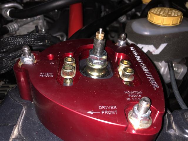

I get them and I am assuming since I already have MCS that the raceseng cam cas plates will fit no problem. This was NOT the issue. I removed the old ones and went to install the new front coilovers and there is some play in the collars. WTF.

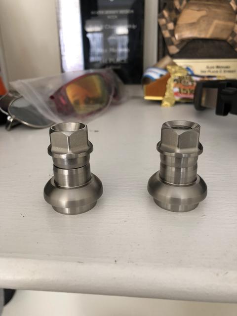

I talked to raceseng and they sent me the parts that they stated was all I needed to make their cam cas plates work with my 2wnr. I spend about $50 in hardware from raceseng and try to install it again.

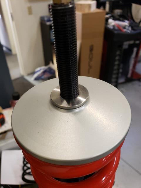

Now when the top nut is threaded all the way down, and I put the car on the ground, there is a gap between the bearing and the nut. This made me angry because they stated people run this set up all the time. Unfortunately I was told by a few friends that I needed to fab up some custom collars to run MCS and they wont work out of the box. I put my faith into Raceseng and he referred me to McMaster Carr to get some parts.
New raceseng hardware. upper spring perch bushing and m12 shock nut.
Picture showing the gap. I would need something under the cam cas plate to fill some void to make sure the nut can be tightened
I decided to ditch the raceseng cam cas plates and include them with the sale of my old shocks. I called Ground Control and they confirmed that their raised tophats work with my MCS 2wnr.

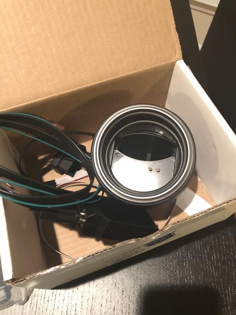

So since I figured I had some time and I was done spending money I decided to make a new exhaust turn down. I blew a 98 decibel reading at nationals. It was my last run so I didn't get in any trouble, but I don't want to be talked to again. Instead of buying a new exhaust I picked up a 3" short race muffler, a 4" to 3" exhaust adapter, and a 90 degree turn. I went to a friend and he was able to weld it up for me and polish the tip

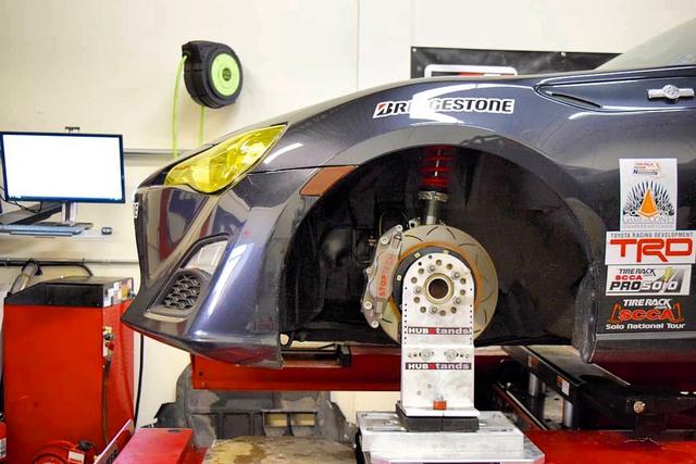

The day I was bringing the car to the shop for an alignment and corner balance I decided to put them on and set them on a reasonable setting. Drivers side went smoothly. On the passenger side however, I found that the knob was completely seized. I tried what I could to unseize it but to no avail.
Well this made me angry. If you remember, I only purchased new front 2wNr and I was going to try to stick out the season on the rear 1 ways. So now I had a decision to make. Send the rears in for rebuild, or buy new MCS 2WNR to match the front. Since I have been unable to sell the old front MCS I decided it might be easier to sell them as an entire kit so I purchased new rear 2WNR through Karcepts. What is awesome about MCS is that I ordered them on a Monday, they were built on Tuesday, and overnighted to me on Wednesday. I brought them to the shop doing an alignment on Thursday and I was hoping the car would be able to be picked up on Friday.
Well nothing is as easy as it seems. Especially in my case where Everything I install on this damn car seems to give me issues.

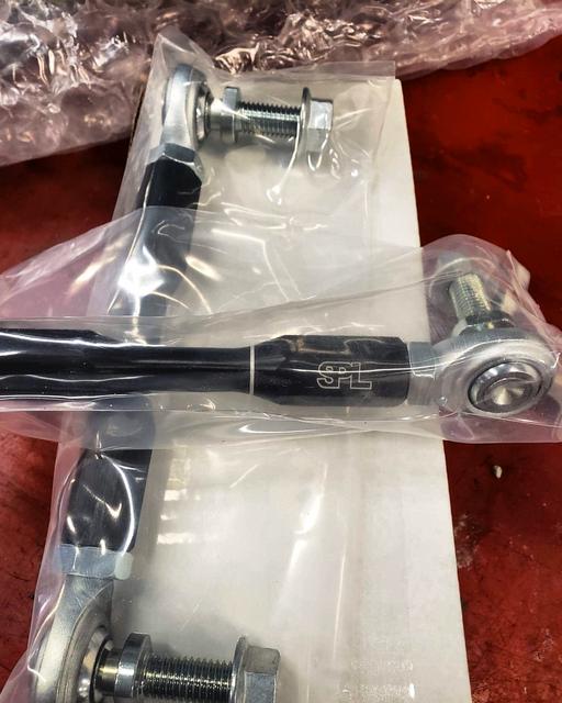

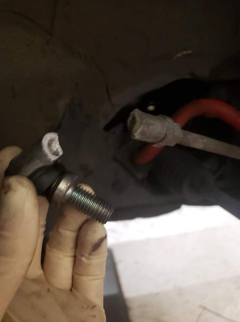

First, when the shop decided to adjust the front endlinks they found this..

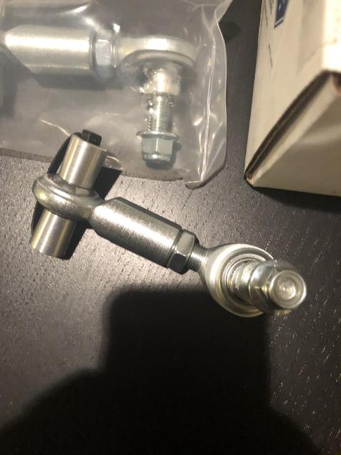

These were 11 month old Hotchkis endlinks. The car has never seen snow. Im not sure why the broke in such short time.
A quick call to SPL and I was able to have them overnight me a new set of their front endlinks. These things are pretty.....
So I got those installed.

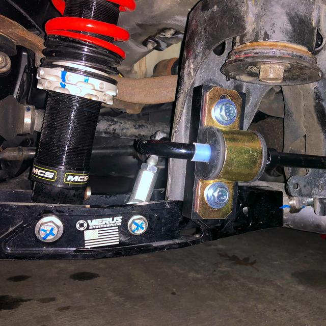

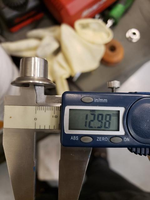

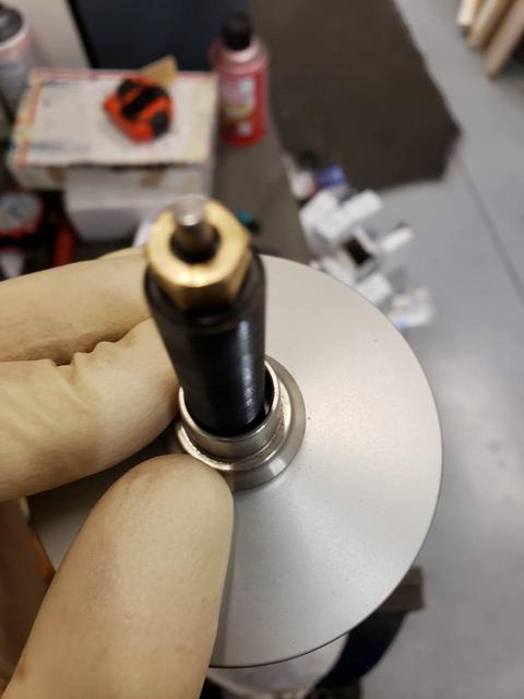

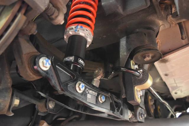

Then.... the rear coilovers were ready to be installed and surprise surprise.

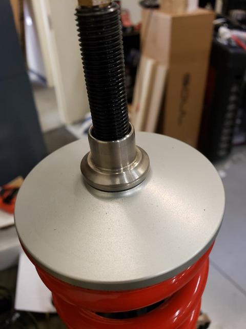

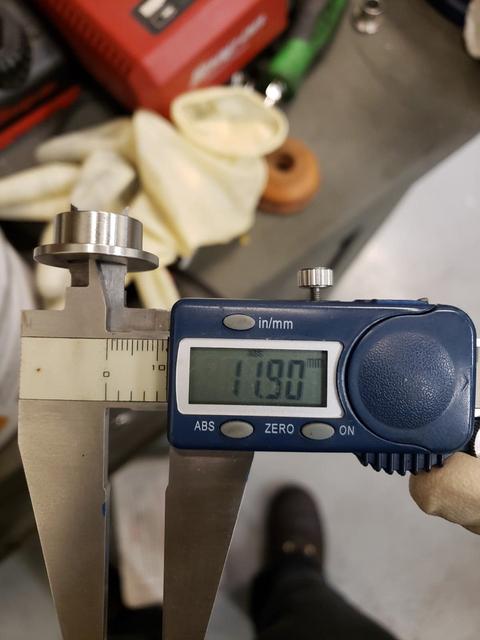

My new MCS 2WNR are not the same as my old MCS 1WNR and the tophats had some play in the collar.
So, we call Raceseng… again. He overnights some parts to me and the new parts actually work great.
One thing to keep in mind when putting together rear coilovers that do not come together as a kit is to make sure there is plenty of articulation between the top hat and the upper spring perch. MCS told me that you need at lease 6 degrees of articulation to prevent damage to the assembly. Also, when installing top hats on high end coilovers, make sure that the adjuster knob is somewhere in the middle of its adjustment incase the shaft spins a little.
Here is a picture showing plenty of articulation. this can be accomplished with 12mm ID washers.

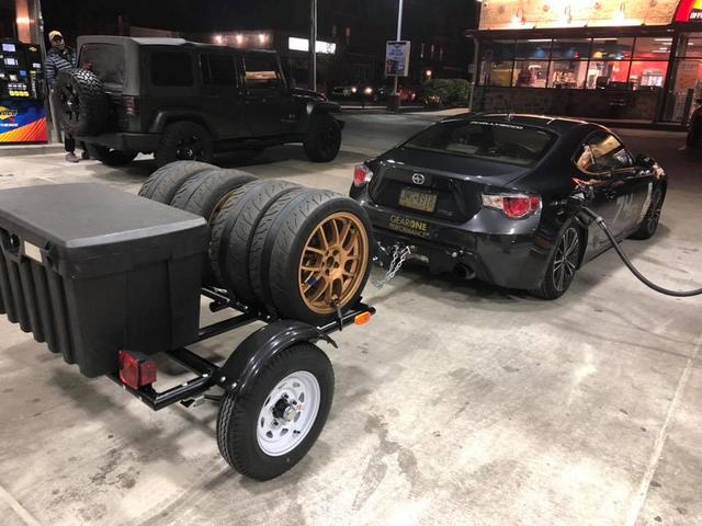

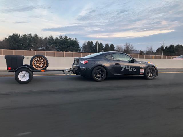

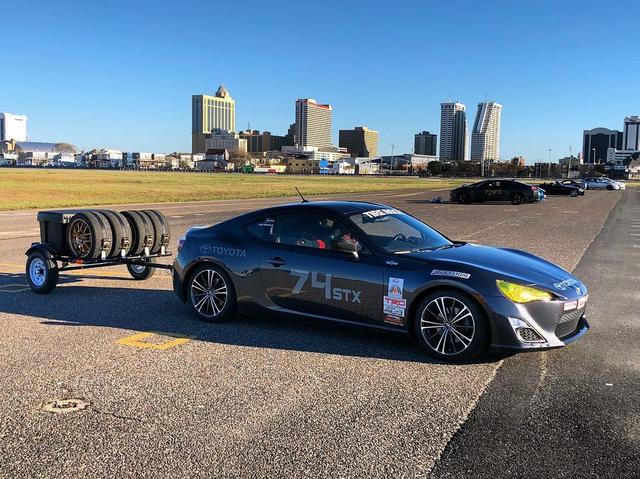

Recently, after the whole loading up the car thing for my trip to nationals I decided to purchase a LeRoy engineering tire trailer. I bought their cheapest one. I think it was called the Elemental.
Not gonna lie. The trailer is one of my favorite parts of the car.

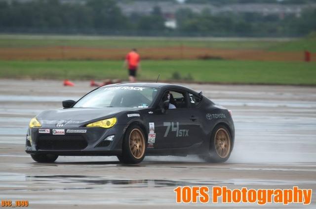

First weekend in the books.

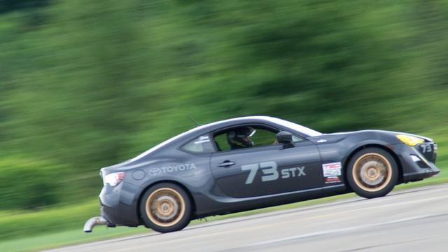

Saturday was Northern New Jersey Region's test and tune. The day started out slow, the car was pushy on initial turn in in sweepers, and loose on throttle. The car felt great in slaloms and offsets. I made some rebound and compression adjustments and the car felt better throughout the day. I chalked up the slower times to it being my first event of 2019 and everyone elses 2-3rd event. I also had brand new RE71s with 0 miles on them.

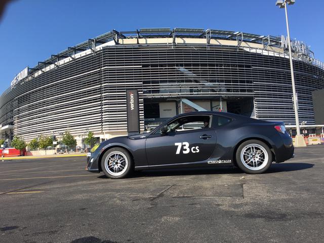

Picture my friend took on the way to the event.
Sunday:
This was NNJR event 1. It rained all day. Lots of standing water. I got 2nd in STX behind James Tatad (National Champ).
Some things I noticed was that the car was insanely loose (rain). I guess I need to be smoother.
-Alex
