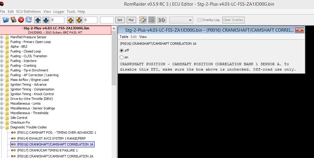

The code is there for a reason but if you insist on disabling(I accept no liability for any damage to your car);
Open your tune in Romraider
Find code
Turn off
Save tune
Upload to tablet
Flash to car
Find code
Turn off
Save tune
Upload to tablet
Flash to car
Attachment 175545
