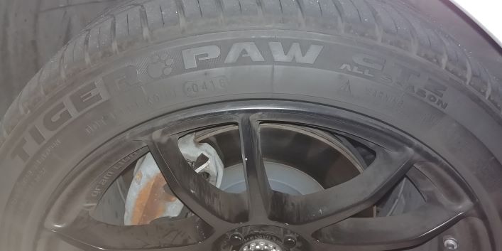

I rotated my tires a few weeks ago and now the rear end of my car feels like I am driving on ice. The traction control is constantly coming on which was never the case before. Any idea what would cause this to happen? The tires all look fine and do not vibrate or anything when driving, but I am no professional.

I am thinking I waited to long to have the tires rotated which messed up the tire if thats possible. Its to bad since the tires have plenty of tread still. Question, I have Rays Gram Lights 57xtreme's 17 inch. The current tires I have do not fit perfectly (245/40-17).
Name:  Rays Wheels.jpg
Will a slightly larger tire rub when I turn the steering wheel?
Attachment 171497
Its possible to rub depending on ride height. Look for marks or spots rubbed clean in the fender area
Do they show any weird wear? Or are one half significantly more worn then the other?
You could always change them back and see if it fixes itself.
