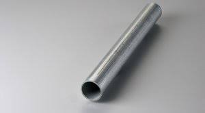

Def need breaker bar with those tiny spanner wrench. My previous car's coil seized and I lost my spanner wrench, so I used this instead (not exact, but pretty close).
With WD40 and this tool, I had enough space to grab with two hands to break through the seized spot. I didn't need breaker bar.
VoltsFRS2013 (05-04-2018)
jesus christ bro LOL.
