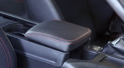

There are two OEM armrests for the FR-S. There is the Toyota OEM armrest that looks like this:
And there is the Scion OEM sliding armrest that looks like this:
Although the first one is much better looking, I went with the second one because it's more practical and puts the armrest pad higher for us taller Americans. It also makes it possible to actually use the cup holders as cup holders by sliding the elbow pad out of the way. However, I use a seat wedge cupholder I got from an As Seen On TV store in a mall, since the OEM cupholder puts the cup right in the way of my elbow as I'm shifting.
I installed my armrest with rivets. It's quite solid when installed that way. It came with templates for the holes. My advice would be to take your time and measure more than once to make sure you get the templates in the right place. Although it's probably an easier job if you remove the center console from the car to work on a workbench, I did mine with it still in the car and didn't run into any major difficulties. I wouldn't expect the flopping door armrest to be any more difficult to install.
