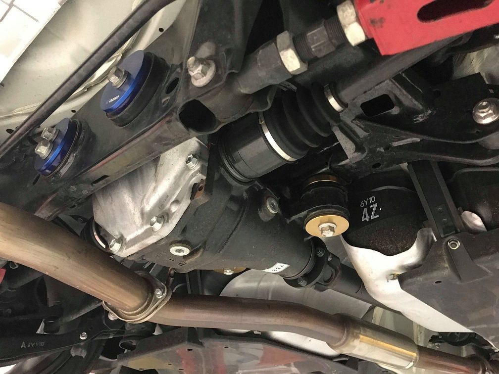

Beatrush F. Diff Collars
Beatrush R. Subframe Collars

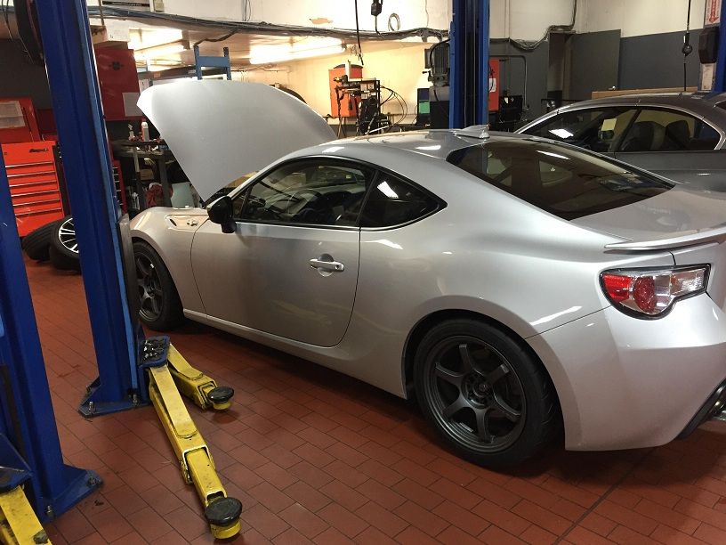

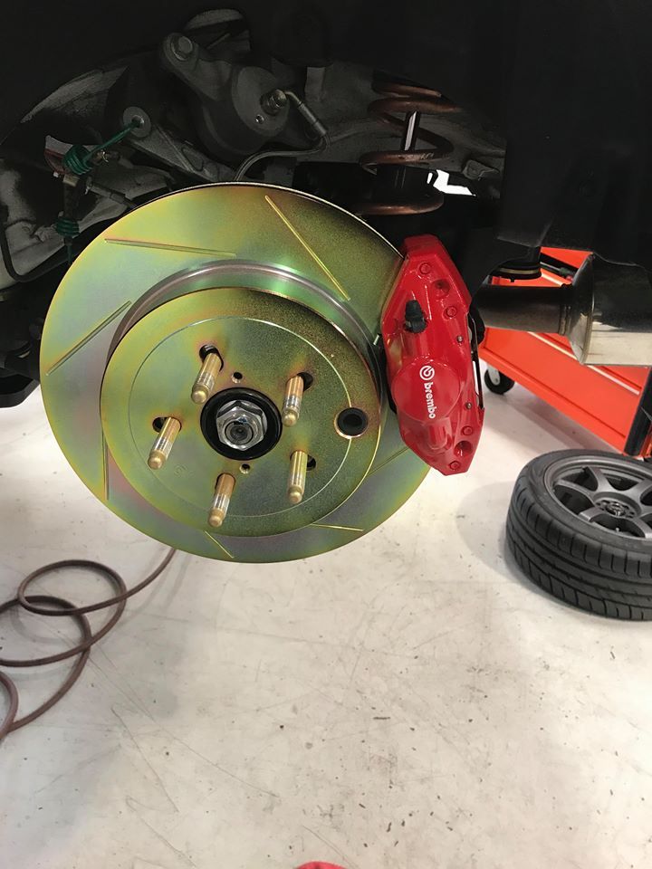

2014 monogram, I was able to do 2 track days before the incident. Vehicle had grimmspeed intake, hks premium exhaust, cusco oil cooler, tein flex z, rsr rlca, rays 17x9 57dr with 245 re71r.
2017 in stock form

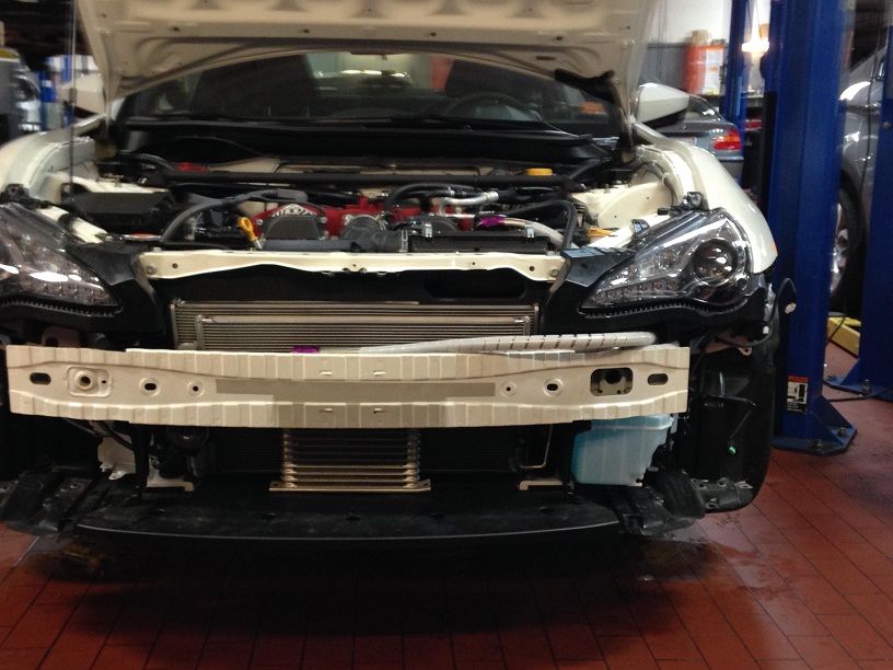

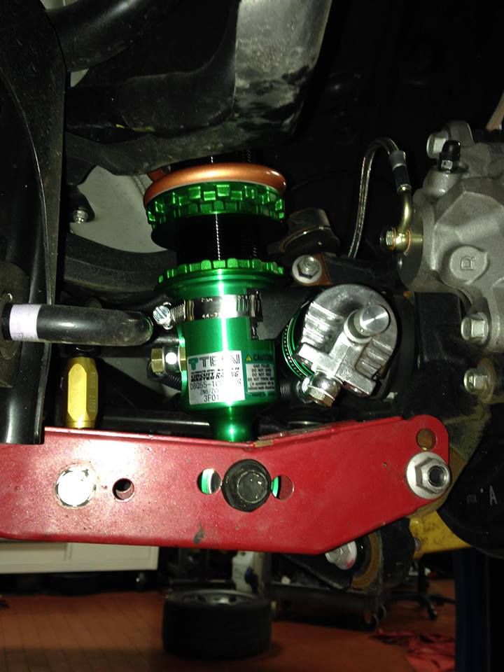

Other then installing the parts I could salvage from the monogram. One of the first mod I did was to add a hks oil cooler. The 2017 MT had a slightly different airbox and conflicted with a lot of oil coolers. HKS clears the airbox but needed to make bracket for the oil cooler.

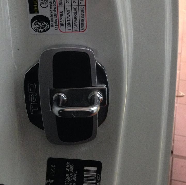

Was debating if I wanted to reinstall the TRD door stabilizer on the 2017. I couldn't say no to TRD parts lol.
Installed radium brake brace.

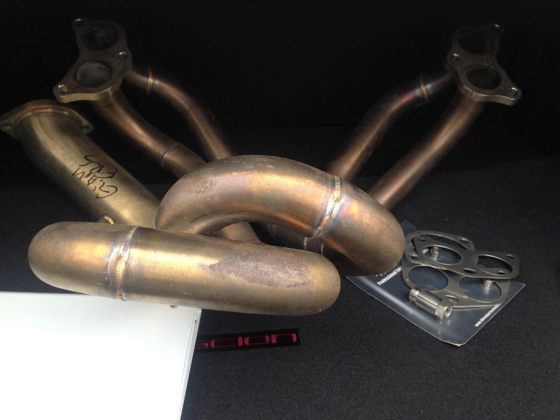

Nameless Long Tube Header I purchase from a member here

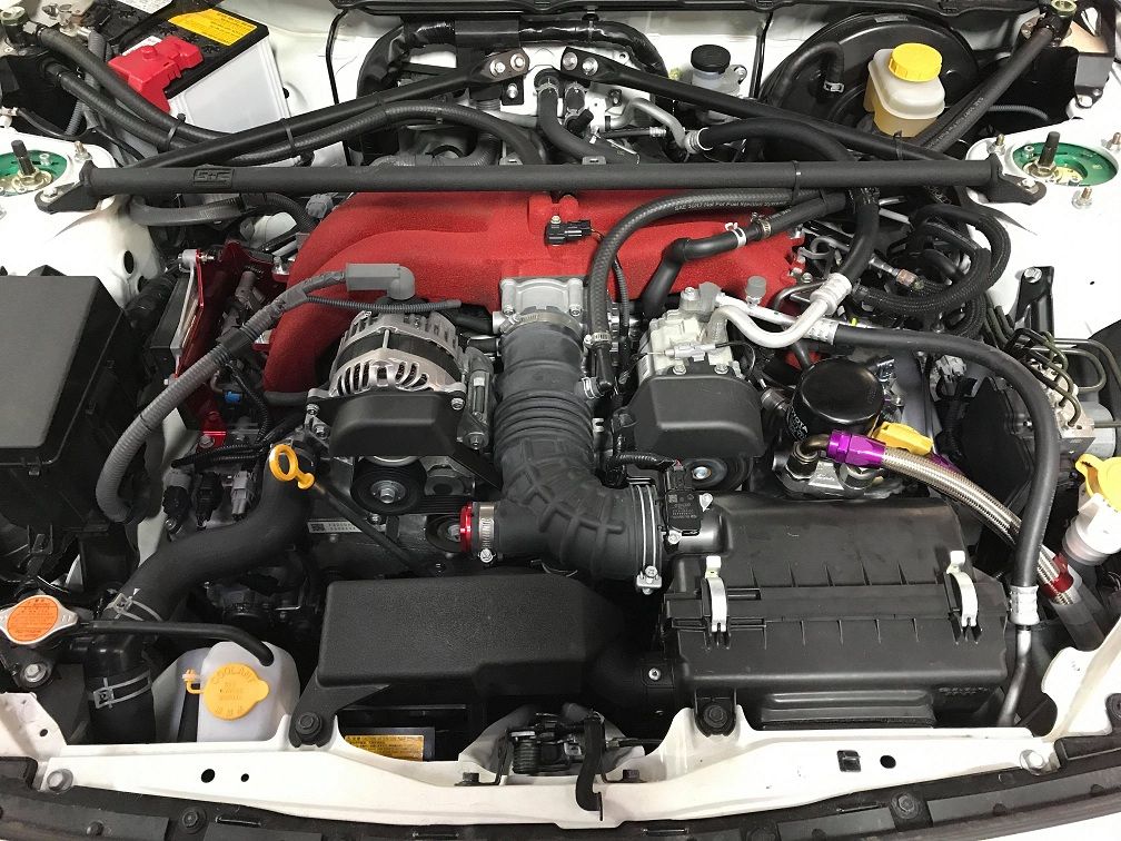

Picture of the engine bay.

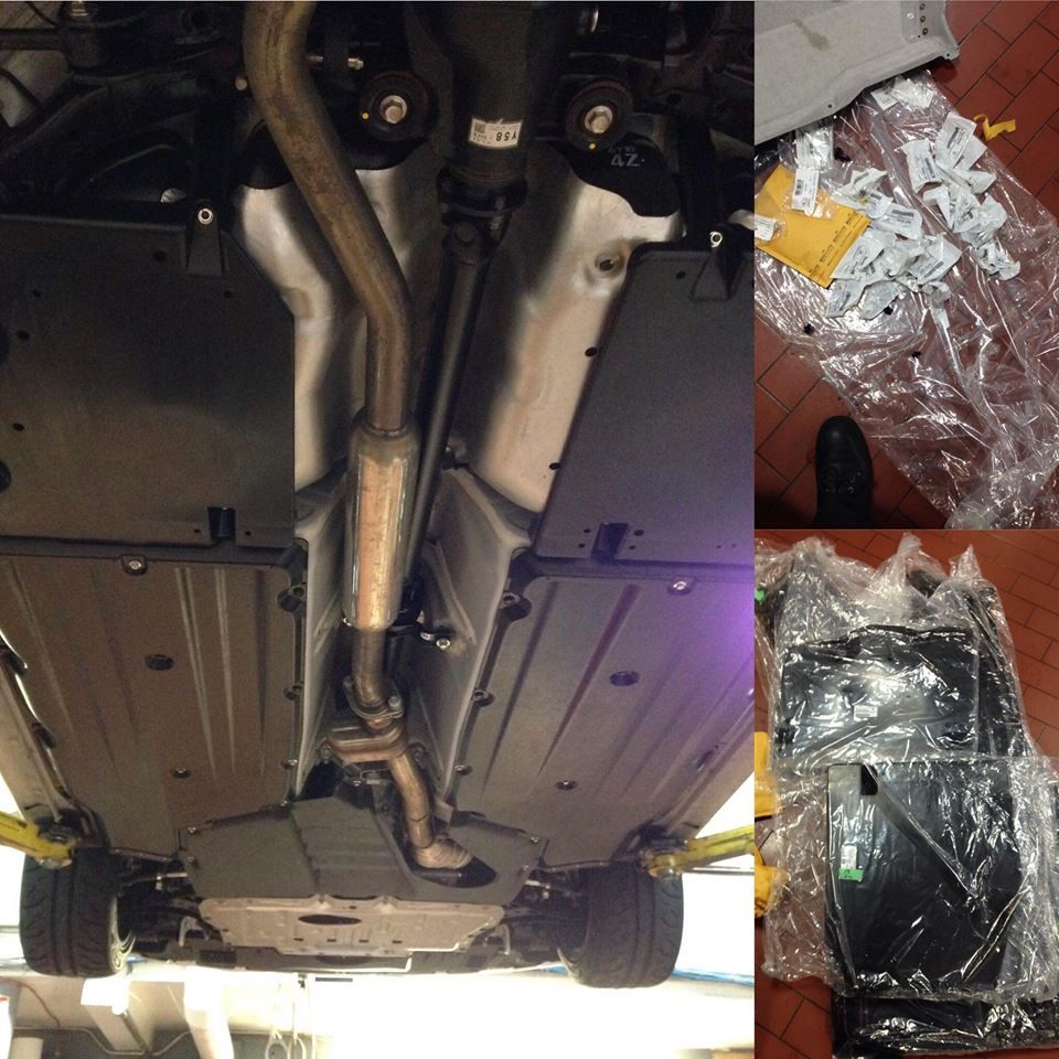

Installed JDM underpanel, was surprised with all the small bags for each clip

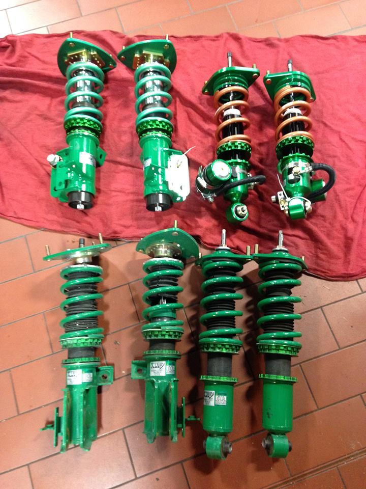

Decided to change from Tein Flex Z to Tein SRC for more track purpose.

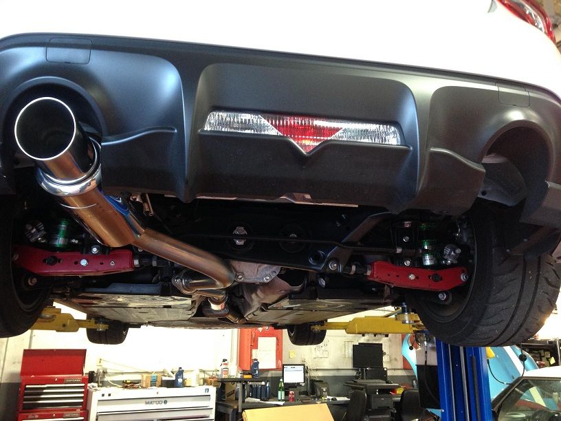

Installed Tanabe Medallion G

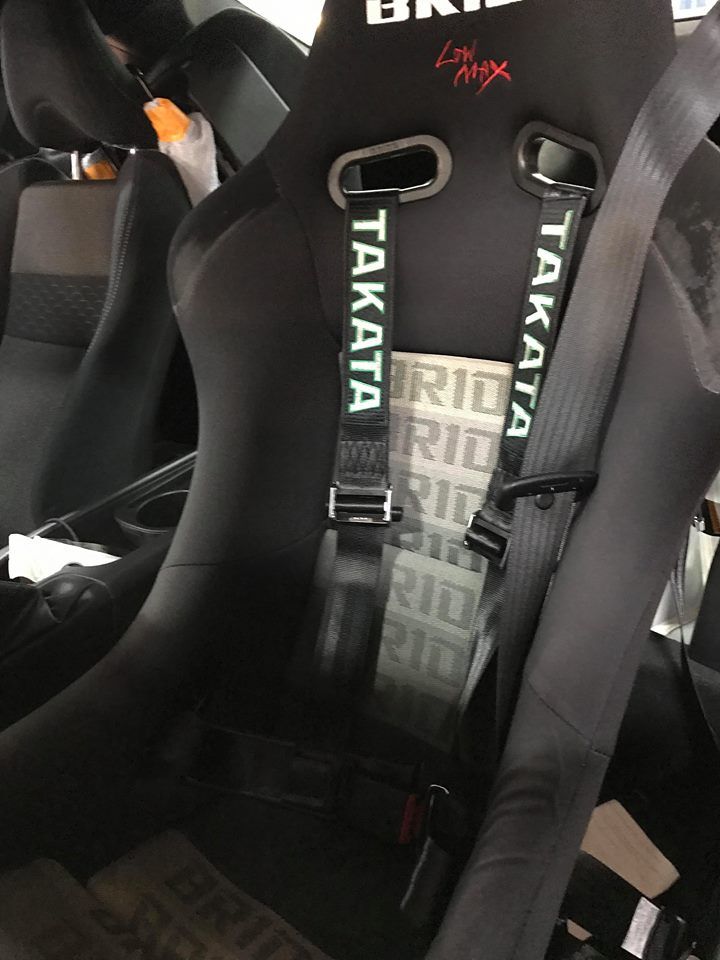

Installed my old bucket seat I ran back in my RSX and added Takata ASM harness.

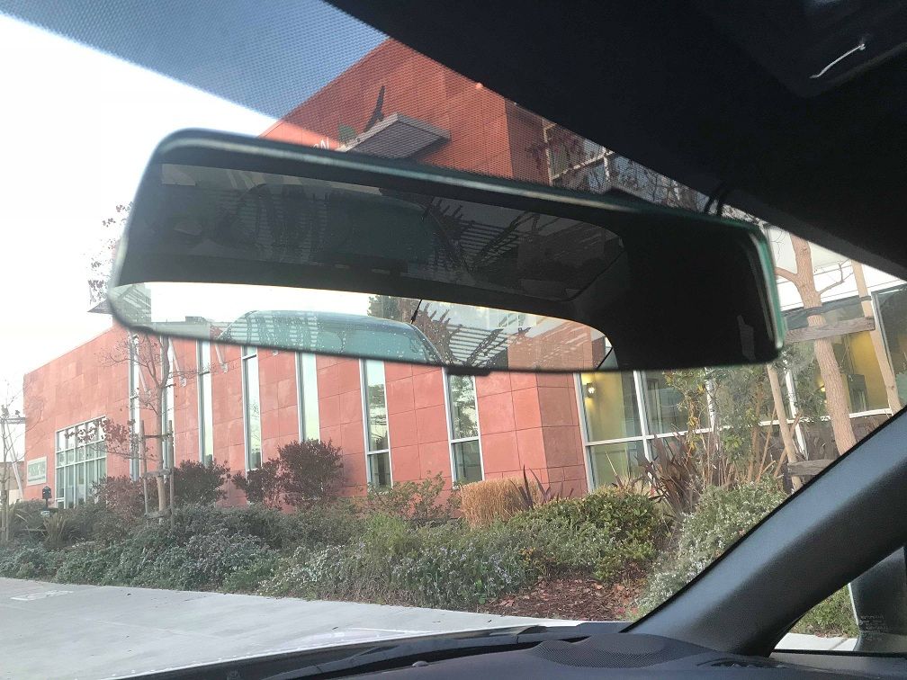

Installed JDM Frameless mirror. One of my favorite little feature in the monogram I missed.
Installed bunch of inserts and collar from cusco and beatrush.

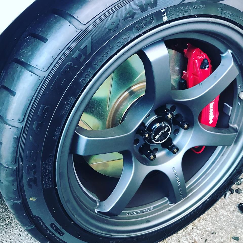

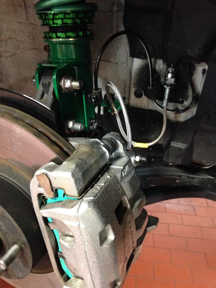

Installed CSG Brembo GT BBK with ARP extended studs
Installed rear Brembo GT BBK with ARP extended studs

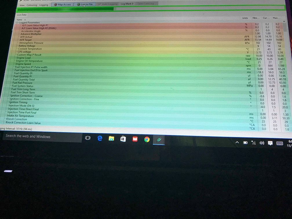

Remote tune with delicious tuning. These guys are amazing and definitely recommend going with them.

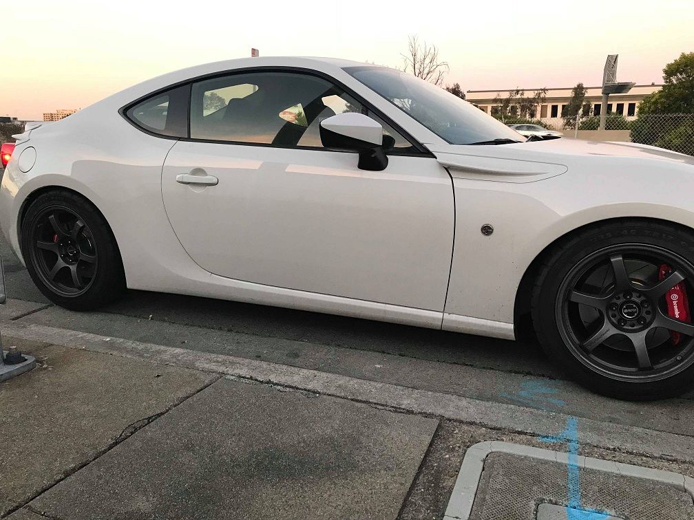

Side view of the vehicle. Also should note that I had TRD fender fins and TRD 3pc rear spoiler.

Would love some more pics! This car seems like it's very well set-up! How much clearance do the 57dr's have from the BBK?

I'm running 5mm spacers in the front to be safe. I believe the GT are about 6mm wider then the PP, so I think might have a chance to clear but I didn't want to risk it.
I wish I had taken more pictures on the build, found whatever was in my phone. Will be taking more pictures from now on.

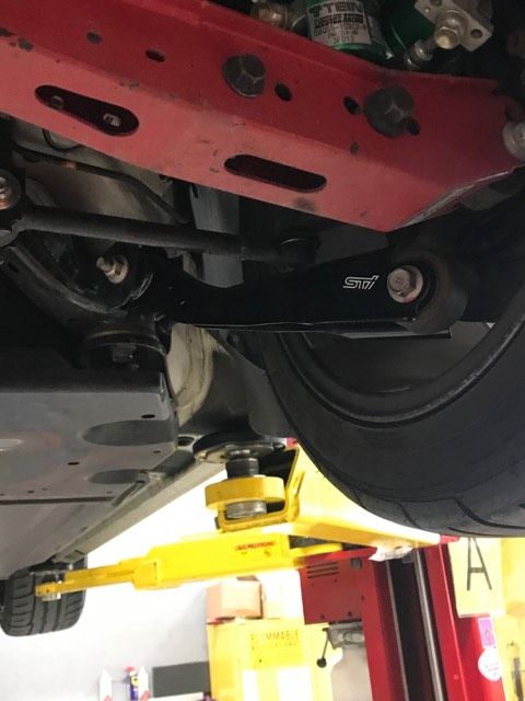

Installed STI trailing arm. The STI sticker looks a bit generic, my guess is that its rebranded TRD trailing arms.
