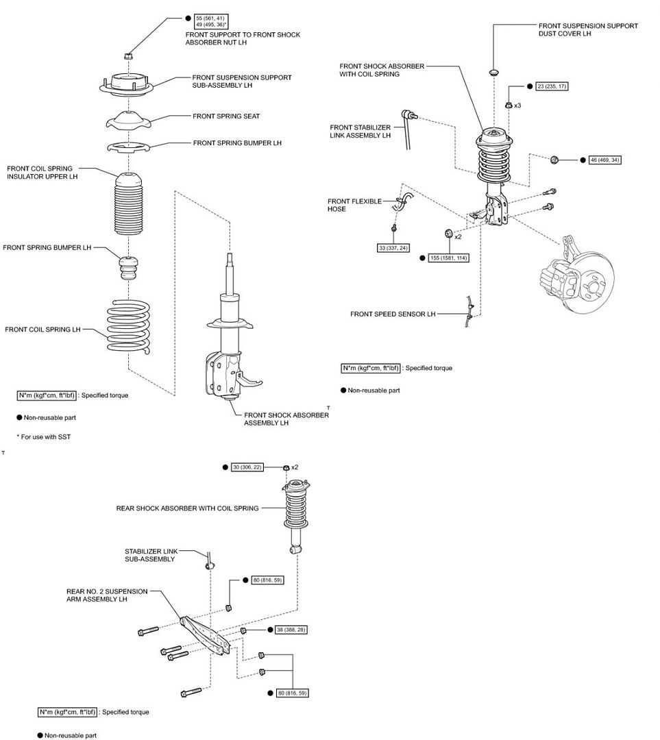

What sort of creaks and groans? A stiffer suspension setup will amplify noises and rattles in the car, but you shouldnt have any really noticeable noises. If anything, doublecheck everything that was touched and make sure its torqued to factory specs.
My new suspension doesnt make any noises that werent present with the factory suspension. Make sure all spring perches are tight and check for any binding.

Heim joint top hats tend to be pretty noisy. Not sure if that's what you're running.

Thanks for the info and the diagram!!!
