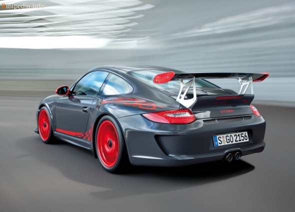

Hi pals!
I've a BRZ with Rocketbunny v.2 kit, which comes with an aggressive ducktail spoiler and recently installed a wing on the trunk together with the ducktail.
The car itself is a track tool with ~500hp, custom splitter and full flat underbody and aggressive rear diffuser, which ends the underpanels nicely.
Ducktail+Wing combo look VERY unusual to the eye, still thinking if that couple could have some future, so needing your TECHNICAL ADVICE. Let the cosmetics sit aside, that's too personal.
Technically, pls, will this combo allow faster laptimes or they just ruin the hella of all aerodynamics.
If one could illustrate the flow path in this case will be my hero )
Yours, Mike
BTW, GT3RS has the same combo for some reason, as long as the Cayman GT4 also

Tough call without a tunnel, of CFD.
The wing should be more efficient, better L/D. Spoiler should have a higher drag penalty. Then the question of the interaction...will the spoiler choke the under wing flow? will the combo move the Cp too far aft, ie more than you can dial out with the wing angle of attack?

The difference is, Porsche has put R&D when building their cars whereas that BRZ just slapped together parts that looked similar in hopes of achieving similar results.

You could try yarn tufts, flowvis (or engine assembly lube), but that will only get you surface flow, and attachment. A pressure rake would be ideal, but outside a tunnel, you are dealing with changing environmental conditions. You couldn't accurately reproduce back to back tests.
Wing won't reduce drag, it should have less than the spoiler, but it will add drag.

That spoiler is more of a gurney flap imo which will add a bit of drag.
I would get a TRD spoiler because any air that's not going over the wing needs to GTFO the back of your car as fast as possible. I am in no means an expert on aero but I could see an actual spoiler reducing the turbulence of the wake behind your car at speed.

Really good answers in this thread. I'll try to add something to it.
From a lot of reading and other people's data:
For the wing to work properly, you need higher velocity air under it, and lower velocity on top of it. The bigger this differential, the more downforce it generates. The bigger the angle on the wing, the more drag it creates but the more differential we have (so more angle = more drag and more downforce).
Spoilers work a little differently. In your case, its a more of a gurney, which increases pressure on top of your trunk by creating a almost stagnant pocket of air. Small downforce gain, lots of drag. But it also allows the air from the top of the vehicule to stay separated from the bottom for longer, so the turbulences behind your car are farther back, which reduces drag. So all in all, small downforce, small to medium drag after considering it all.
Spoilers like those in the porsches have a way lower angle, they dont work like a gurney flap they work more like an extension to the trunk, giving the benefit of reducing drag by increasing the distance of the turbulence behind the car, but without adding much (if any) drag to it. They do not disturb airflow velocity under the wing, so they can work with it without any problem.
A wing that is close enough to the trunk will produce the effect of both, a spoiler, and a wing. But since there is a lot less air passing thru it, it generates less downforce than being put higher up. So if you want to maximise downforce while reducing drag, you either put the wing really close to the trunk, or use the wing together with a small spoiler with a very small angle (if any, think of drag spoilers, almost flat). Porsches have the second option here.
The worse case scenario would be the wing high up with a very steep angled spoiler or gurney flap on the trunk. You generate massives amount of drag and only moderate (or even small) amounts of downforce.
All of that is from theory, lots of reading on aerodynamics and CFD.
From my own data playing with my wing angle (APR GTC-200). My car does not have a trunk spoiler of any sort but does have front splitter and side splitters (horizontal skirts). Negative angle on my wing (around -2) allows me to have around 10mph faster speed at the end of the straight vs max angle (around 15). The car is neutral mid corner on corners above 60mph or so, loose in corners below that, slight understeer in corners above that speed with negative wing angle. The car understeers like a pig at max angle on anything but hairpins. Highest lateral Gs were achieved when the car was understeering a lot with max wing angle, but fastest lap times were with the wing at negative angle. Havent had enough time to play in between.
