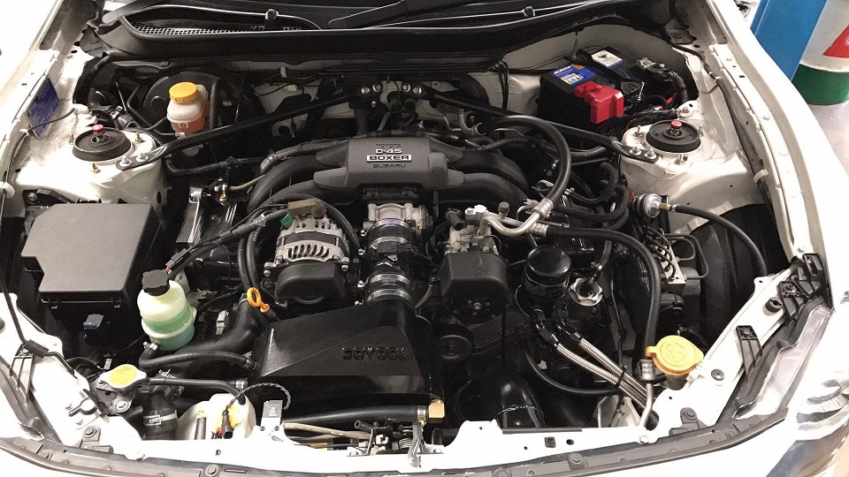

Coyoda Turbo Kit Thread.
Hey all.
Alot of turbo kits have there own thread thought I would see how many Coyoda Turbo kit users we got on here!.
I had mine installed over the last few weeks by Alan Butler (Turbo Yoda) as mine was customized a bit. I came from a SME turbo kit another Australian kit but seeing how well the Coyoda was performing I had to change it up.
Not sure on power output its currently with Tony Young (Coyote Tuning) and the tune will be getting done over the next week or so depending what else we find to add in!.
Keen to hear your results and see some pictures
I know this is an Australian only kit right now but there hoping to get it out to other countries in the near future.
Feel free to ask any questions will reply with what I can if anyone is curious about the kit.

I only have this pic left as I droped the car into the Tuner yesterday. Pics of dyno charts etc will come eventually.

What's being used for tuning?
I love the intercooler setup, it's perfect.

Originally Posted by Stimmed View Post
Yup they do some quality work!. And alot of awesome custom stuff for all types of cars 4wds etc!.
What turbo is it using and where is it mounted? If I remember correctly, it's mounted right in the front like most kits, but that custom intake/IC pipe thing (what is that btw?) makes it seem like it might be elsewhere.

Hahah dosent anything fit on a honda?? :P
Turbo is a 3582 its low mounted up the front but you litterally cant see it. Even looking in the engine bay you may get a glimpse of it but you have to really get in close its hidden away nicely.
ATM the software is BRZEdit But I think Tony might be looking at ecutek in the near future but not to sure.
Thats actually the heat exchanger at the front. It runs a W2A setup. Which is sitting under that "Coyoda" labled box at the front of the engine bay. The intake they used to use the standard one so it looked even more stock but issues were to hard to get oil lines in for oil coolers etc. So now there custom making that intake the pod sits in the bumper. Harder to change and check but much more room in the engine bay it self.
Keep in mind this is on an auto. I was going with a 3076 but Tony/Al said with the auto it will mask a bit of the lag anyway and they were very keen to see if they could fit the new bigger turbo down there....and they did!.
Only issue we are worried about is the auto not handling enough power. I have a spare to be built if needed but we will play it by ear. The setup is making alot of torque it should be a blast.
Hope that answered most questions just quote again if I missed any will try and reply
