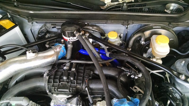

Went ahead and added some cheap silicone radiator hoses for more blue and the Crawford AOS (sans zip ties...):

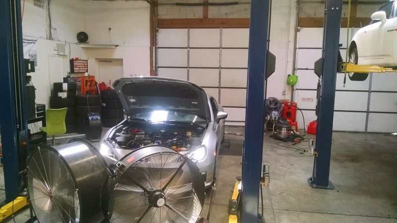

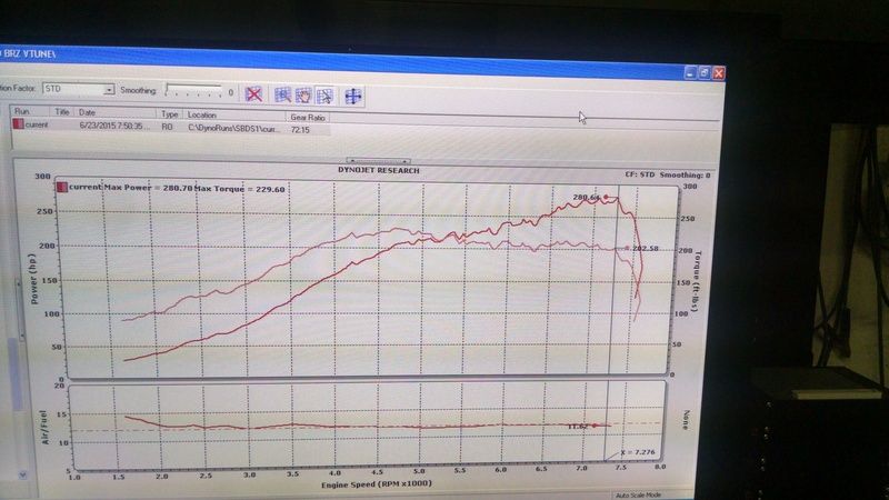

Ready for some Dyno time at Pure Automotive Performance out of Millersville, MD with John Visconti of Visconti Tuning. Thanks for squeezing me in between the Twin Turbo Z car and GTR!
[ame]http://www.youtube.com/watch?v=MABMY7ga6BA[/ame]
So now I should be happy right?

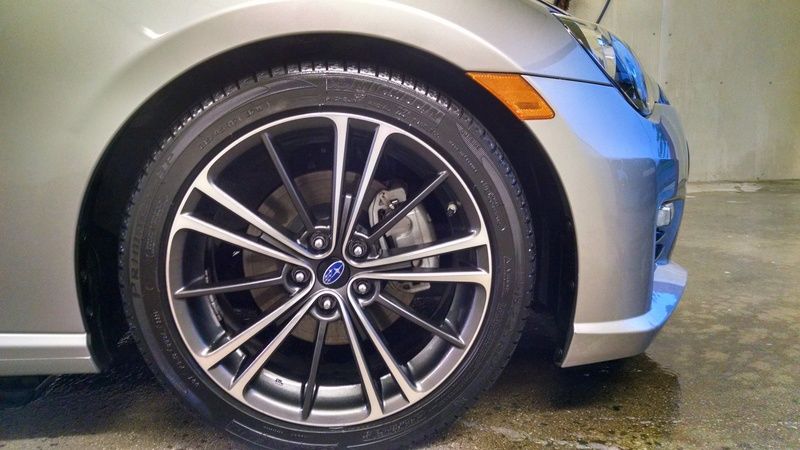

While everything was down I also installed some used BC BR coilovers and 20/25mm spacers for that little touch of flushness without attracting too much attention.
Down 1.5" in front 1" in rear stiffness set dead center all around

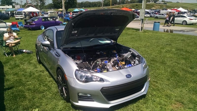

At the show:

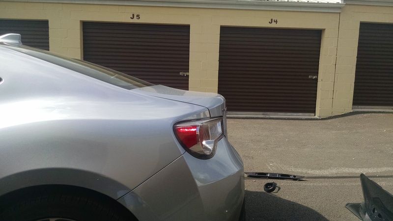

New Seibon Carbon Trunk rough install. VIS AMS Carbon hood in the works.
Also finished up vent to atmosphere setup for Crawford AOS. No pics of that yet though.
Before:
After:
Terrible pics I know, but I'll have more after it is sanded and re-cleared when the vented Carbon hood goes on.

Some notes on the genuine Seibon trunk:
Fitment on the car is good, but the openings for the license plate lighting are awful, so I'll need to silicone these in place. I also had to open up the holes for the license plate mount with a file, which I can live with.
I would have expected fitment to be better because this is a Seibon trunk. I guess the outside fitment is what is most important though.
