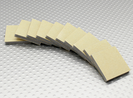

you can also get some thick double sided mounting tape and use it as padding between the trunk and the plate so it won't rattle

see if you can tape it down with some 3M tape...that's what i did with my license plate so it sticks to the trunk

My screws rusted. I replaced them with slightly larger stainless that fit tighter. Then I stuck three layers of 3M tape together behind the bottom of the plate.
