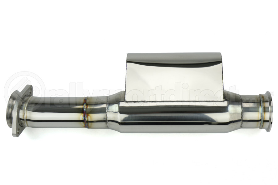

So I finally installed the 0.2 midpipe to complete the 1.2 BRZ.
The install went easier than expected. I had read that in order to install the midpipe, you had to have a lift. I don't. I wanted to see if I could do it in my driveway without having to pay a shop (I'm a problem solver). So I'm here to report that you can install it with jack stands in your driveway. Just raise up the front of your favorite BRZ so that you can comfortably work underneath. Remove the skid plate and the dust shield that covers the transmission so you can have access to the exhaust. If you have the 0.1 axleback exhaust, remove the mid-silencer by removing 2 bolts from the front and removing the felker clamp from the rear. This will give you enough room to work as you have to slide the factory exhaust back to remove it.
Remove the 2 motor mount bolts (simple) and jack up the engine at the transmission. I used the jack located in the trunk. It was a little too short to reach and so I put it on a cinderblock to give me the extra height needed to raise the engine. This will give you enough clearance to move the overpipe section over the crossmember. This was the tricky part. Removing the factory overpipe is a little difficult because of the heatshields. But if you jack up the engine just to the point where the motor mount bolts are no longer in the frame groove, you will have enough room to get the overpipe out. This will also give you enough room to fit the big 3" Cosworth pipe.
Slide the new Cosworth midpipe over the crossmember and bolt it to the header. Bolt the rear of the midpipe to the transmission mount but don't tighten the bolt yet. Reattach the mid silencer by tightening the felker clamp first, then tighten the front bolts of the silencer to pull everything together. Finally tighten the transmission mount bolt to secure the exhaust to the car. Reinstall the shields and flash over to the new EcuTech Rom.
