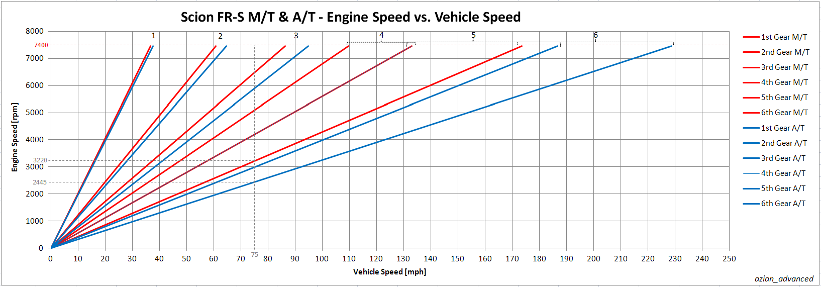

This should help.
Note: P = Premium; L=Limited; AT=Auto; MT=Manual; FD2=4.1 Final Drive; FD1=3.727 Final Drive - No LSD (JDM-Only)
chart in MPH
Here it the same graph in kilometers per hour: link
Also, here it is for the FR-S: MPH KPH
Note: the BRZ Premium data is based on 16" tires for the japanese market, the North American market premium comes with 17" which is the same as the BRZ Limited version.

Originally Posted by azian_advanced View Post
This should help.
OEM tire sizes (tire deflection due to vertical load neglected), OEM wheel sizes, final drive ratios, transmission gear ratios are all factored in on these charts.
I don't understand why so many posts use the wrong tire rolling circumference when taking the trouble to make a chart like this. You cannot just use the wheel size and nominal profile times tire width to calculate the rotations per mile of a tire: it simply doesn't work. But, you don't need to: the tire manufacturers standardize the rolling circumference so that speedometers will work. Just visit tirerack.com or Michelin's website and you can find out the correct rotations per mile for the various tire sizes. The value for 215/45R17 tires is 844 revolutions per mile. The correct chart for the MT limited should therefore show 59.0 MPH for 2nd gear at fuel cutoff of 7450 RPM.
60*7450/4.1/844 ./[3.626 2.188 1.541 1.213 1 .767]
ans =
35.6249 59.0383 83.8260 106.4928 129.1758 168.4170
Note that car speedometer displays are not necessarily exact. I once worked at a factory that made tachometers, gauges and speedometers for Ford and Chrysler. The speedometer settings were set to read about 1 MPH high at 60 MPH on average. I understood that the logic was that it was best to err slightly on the side of the driver thinking he was going faster than he really was to avoid arguments about causing speeding tickets etc.
Last edited by DSPographer; 07-10-2012 at 05:25 PM. Reason: Note that gauges do not necessarily show accurate MPH values.

Ouch, no wonder the FR-S Auto is slow. Look at the graph. The auto 4th gear is the same as the MT 5th. They did the Manual perfect for gearing on the FR-S, I really like it.

So does this mean dynos are done in 5th gear MT and 4th gear AT?

please take down that graphic or fix it,
that is so far off it hurts to look at...
