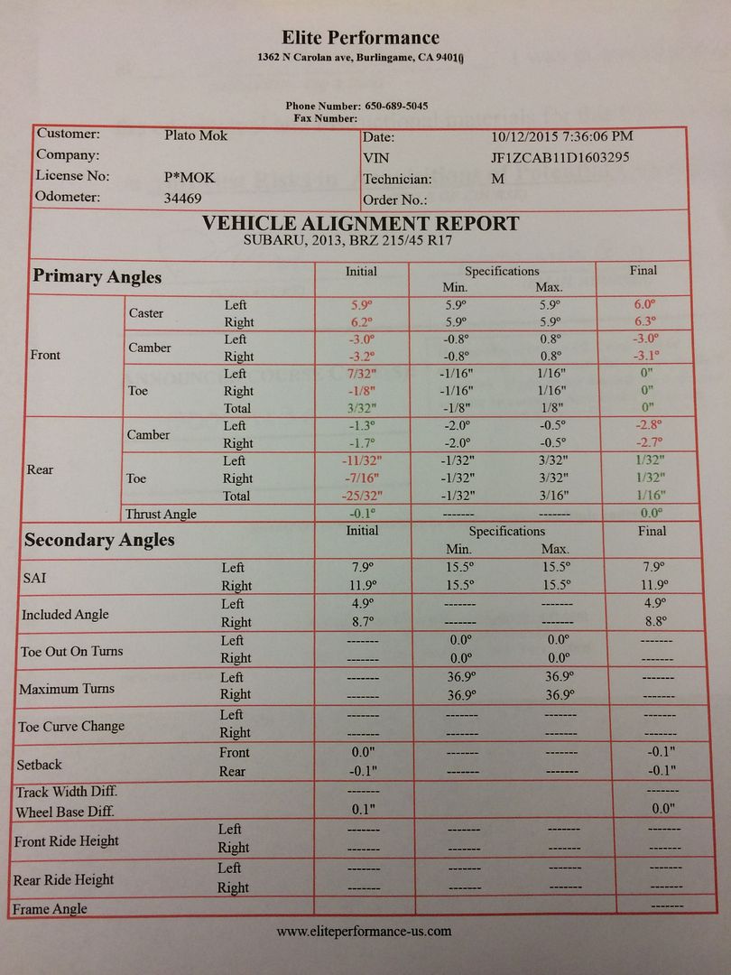

I don't have all the downforce mods you have but here are my alignment specs from last year, on Tein SRC coilovers. Basically you want as much neg camber as you can get, your camber bolts may not allow you to get as much as a coilover up front.

Originally Posted by FR-Sky View Post
How much was the alignment?
Active 86CUP participants get a discounted rate, but I think regular pricing is around $120 for a custom spec alignment. Call them to confirm.
