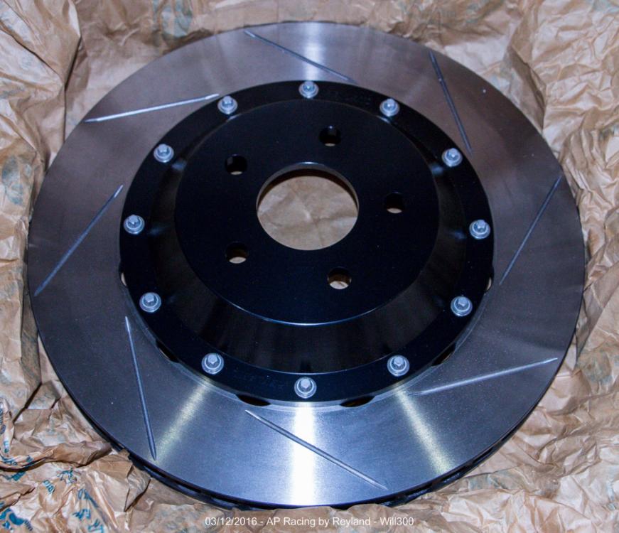

As its now 2017 its time for an update on my build, but first I'm going to start off by wishing everyone a Happy New Year.
Anyway back to the car, I'd originally planned to go supercharged at the end of last year, however due to a supply issue I cancelled this after a couple of months.
I then spent a couple of day thinking about what to do instead of the supercharger, I decided to stay N/A and purchase some more modifications. First on the list was a big brake kit as I've always felt the brakes on the car were lacking some stopping power. This provided a substantial challenge in deciding what kit to go for, after spending considerable time looking at the various options available I came to the conclusion that none of the existing setups matched my exact needs. After discussing this with a fellow owner he suggested I contact a company who specialise in custom big brake kits. Over the following week I exchanged several emails with them and we came up with a kit which meet my needs.

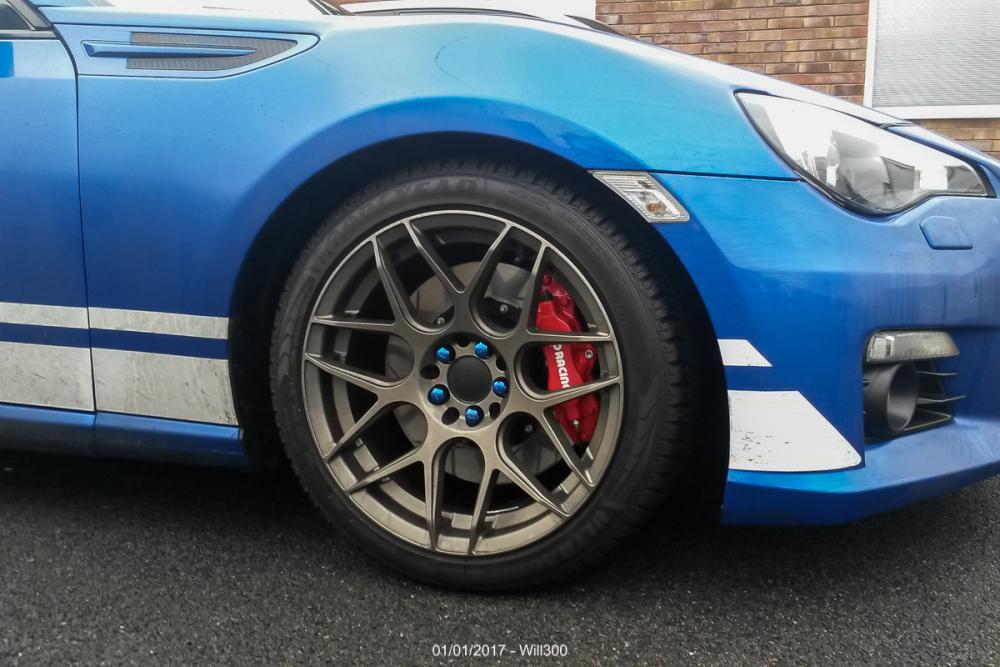

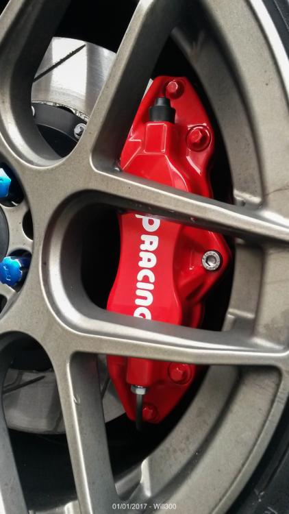

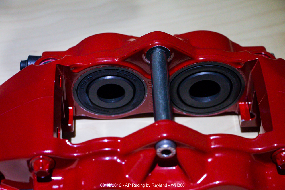

The custom kit I ended up with consists of red AP Racing CP9200 calipers, AP Racing 330x28mm discs with custom hats, brackets and Ferodo DS2500 pads. Here are some photo's of the kit:
Fitted to the car:
I also decided to upgrade the rear disc's to match the grooved fronts, so I selected Stoptech grooved rear discs.
I still need to bed the brakes in, but they feel much better already. (Once I'm back on summer tyres that will help the bed in process massively)

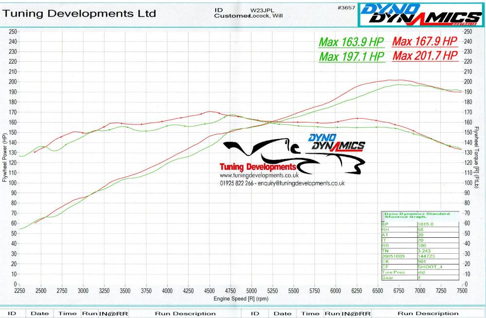

Here is the before and after dyno graph:
As you can see my tuner managed to smooth out the mid range and get a little bit more power up at the top end.
The ACE CS400 is definitely a brilliant manifold for a daily driver, however I'd rather have a 350 but due to being RHD this is impossible.

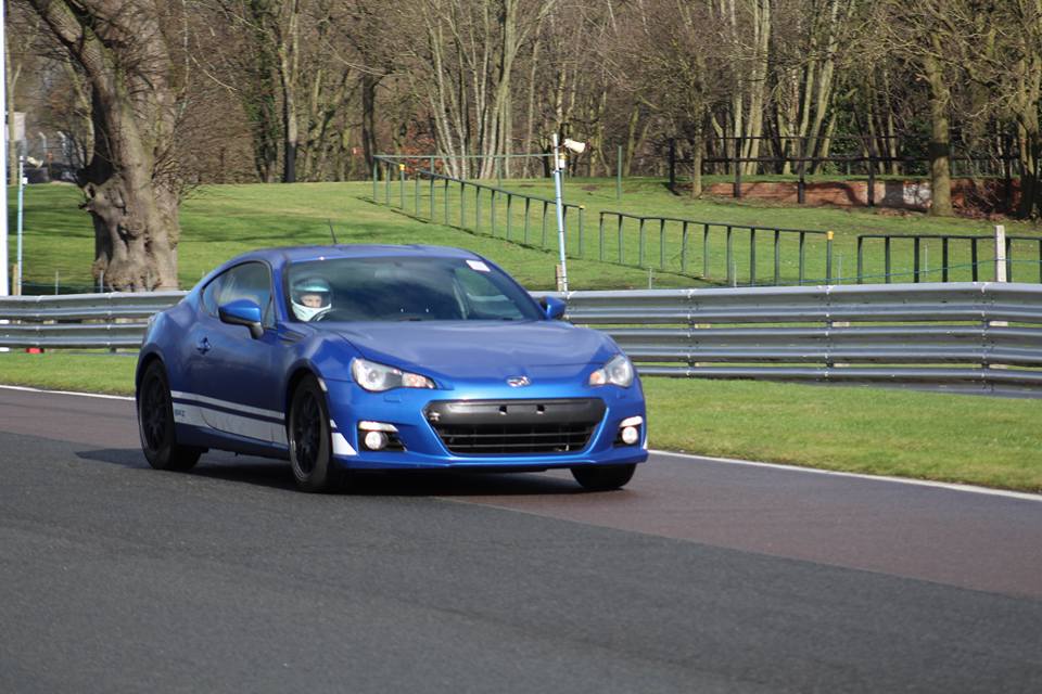

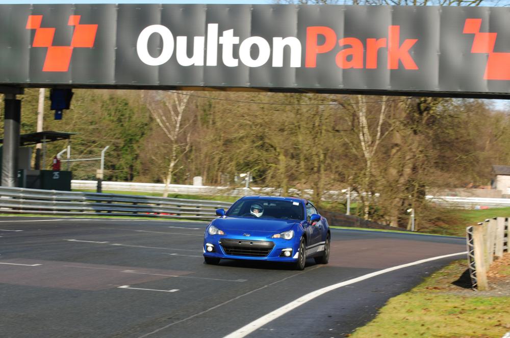

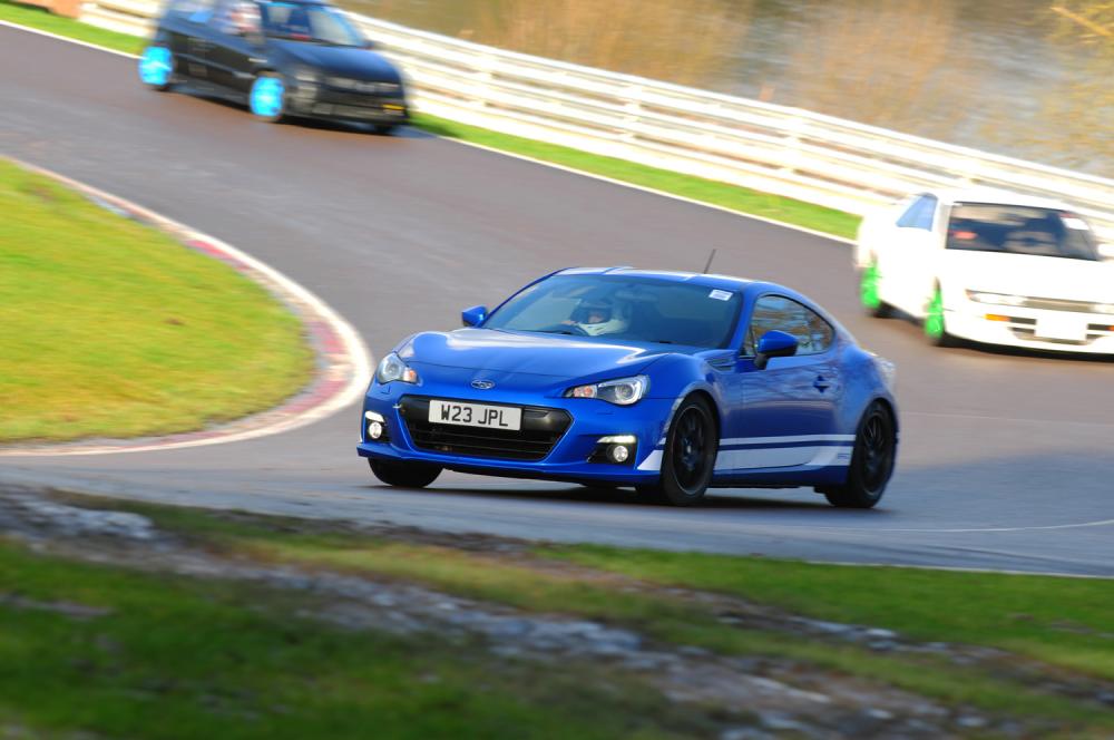

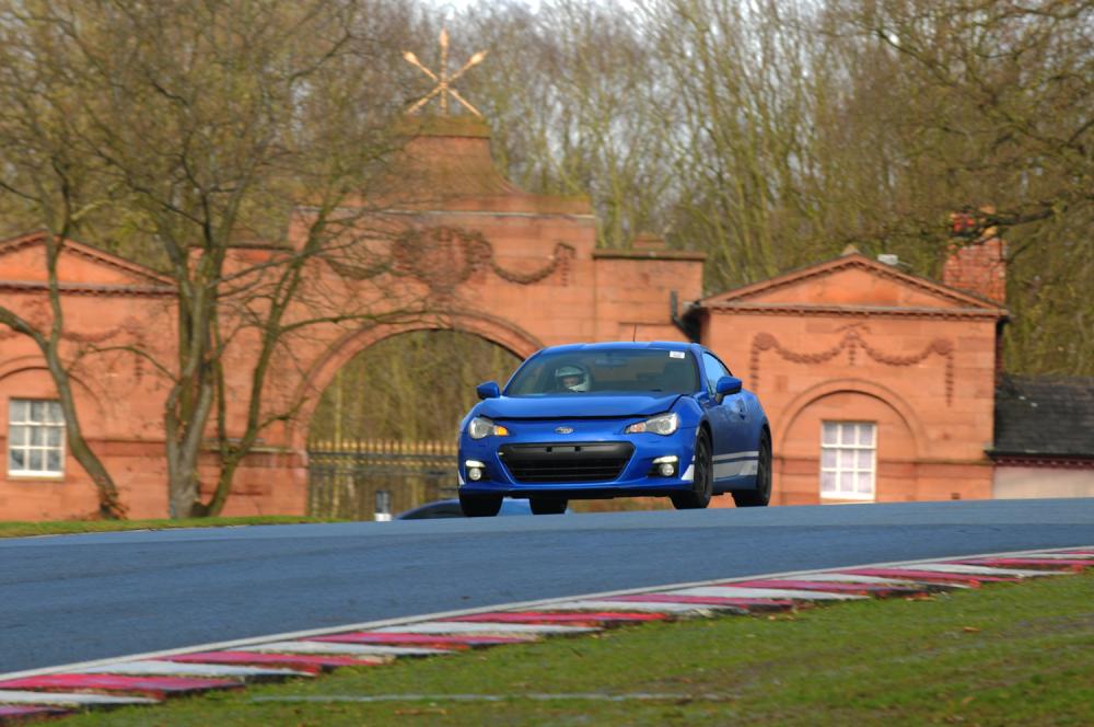

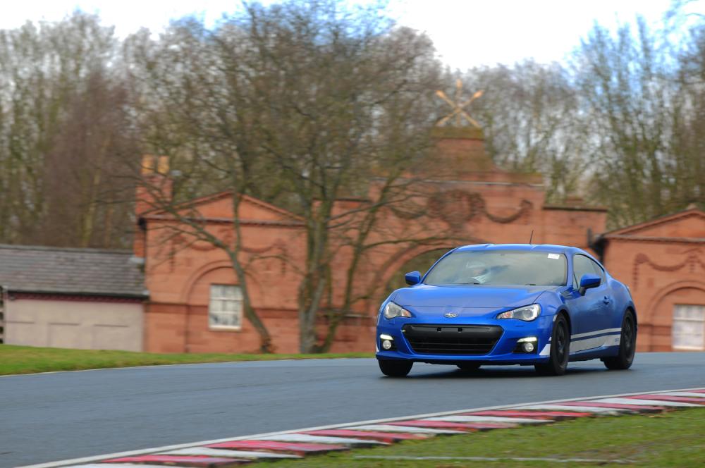

Here are some pictures from the track day:
My Build Thread - Subaru BRZ with ACE CS400 Header, Rogue Motorsport 2.5" Exhaust (Front Pipe & Catback), Tein Flex A, AP Racing BBK and 949 Racing 6UL Wheels.
