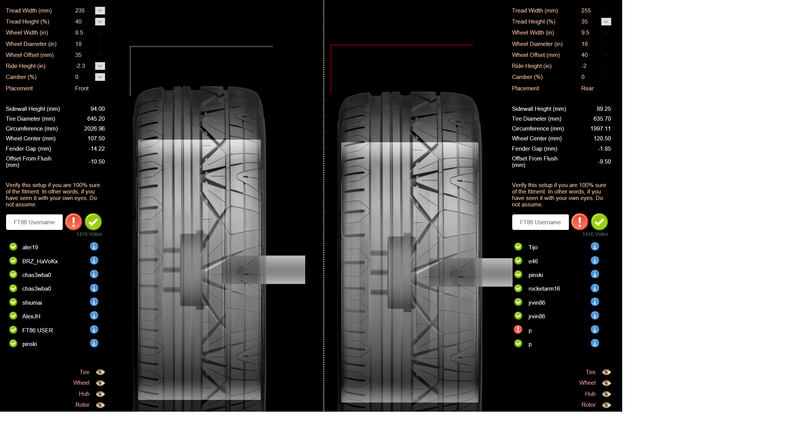

Thanked 7 Times in 5 Posts
Originally Posted by Tareim View Post
This site will help you http://frsproject.com/
Thanks.
Thoughts?

looks like a 255/40-18 up front and a 265/35-18 would fit better.
