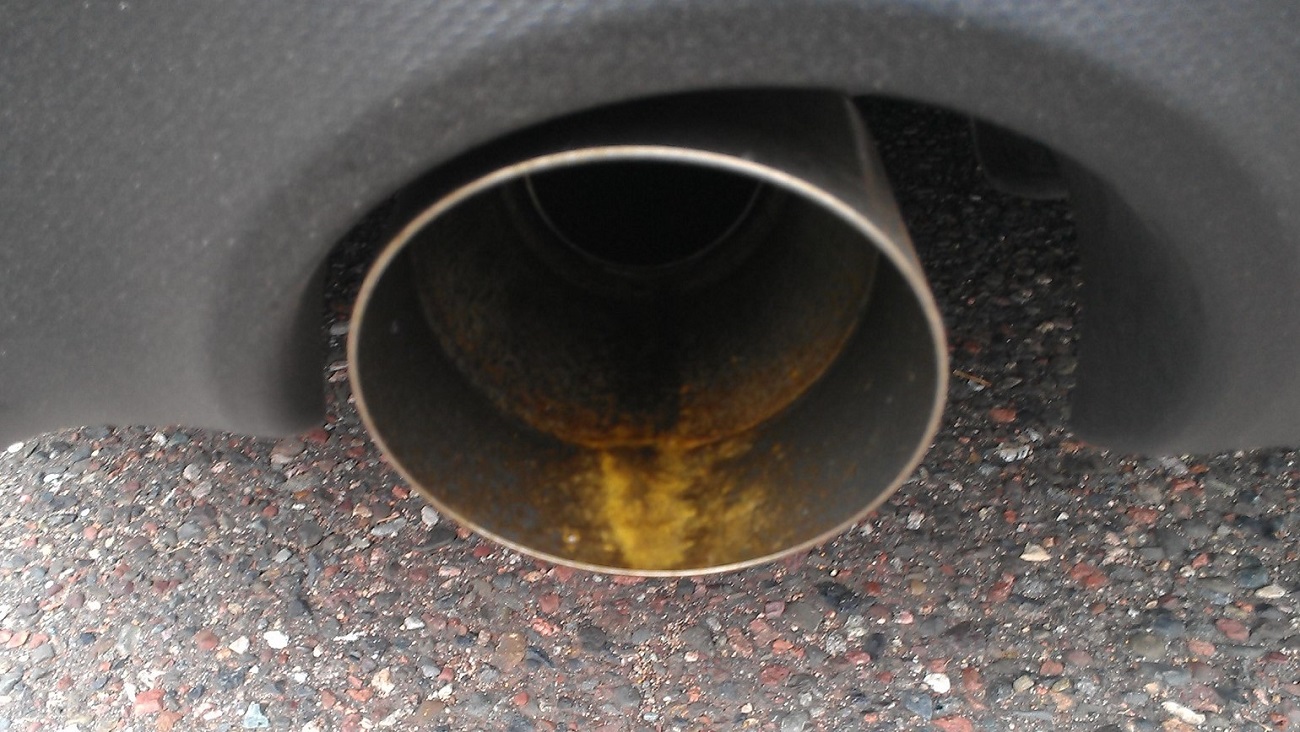

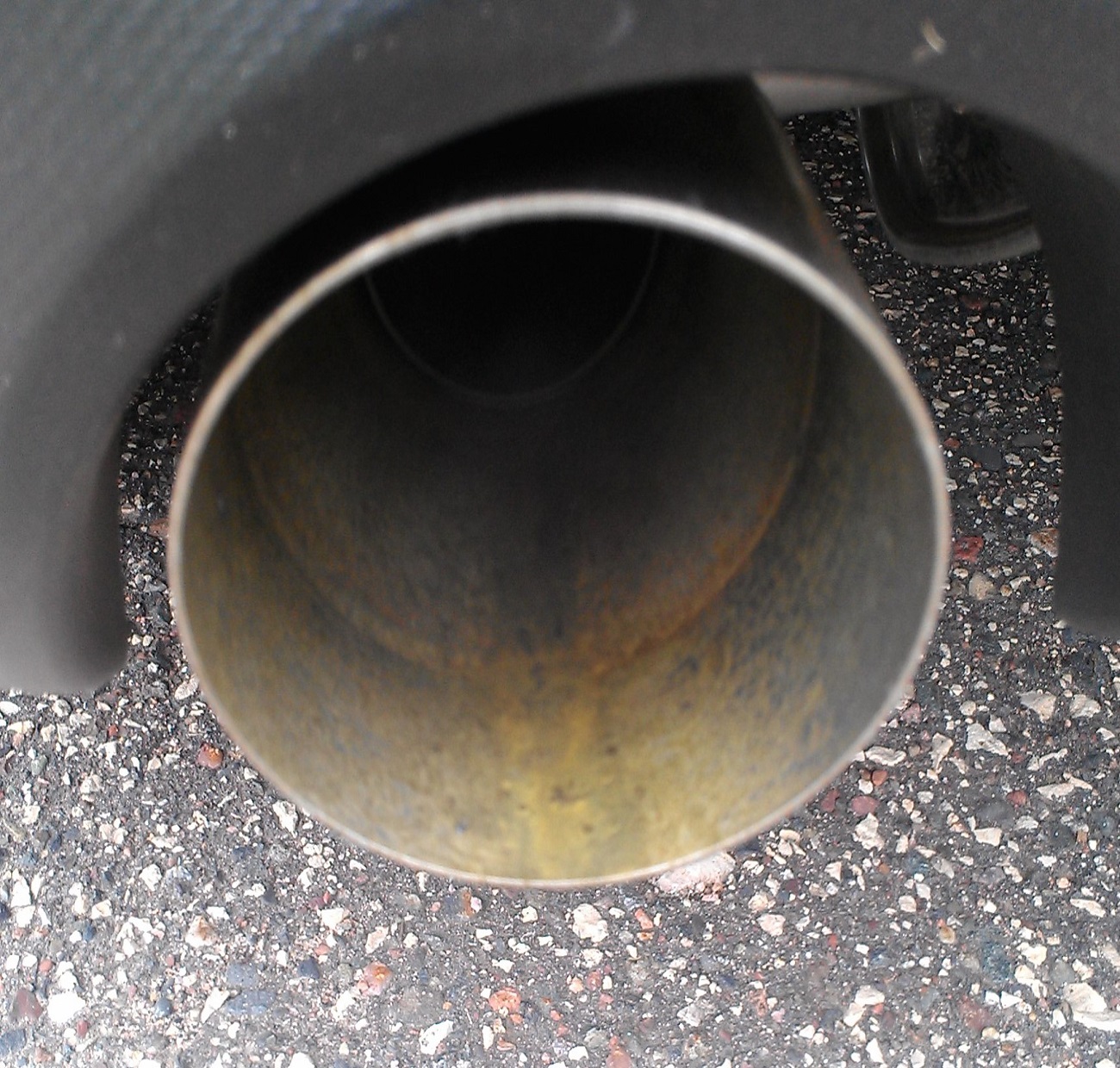

Old 05-13-2016, 11:38 AM   #8
FaDuck
Join Date: Apr 2016
Drives: 2014 UltraMarine FRS
Location: MN
Posts: 74
Thanks: 10
Thanked 17 Times in 12 Posts
Here's a couple pics
FaDuck is offline   Reply With Quote
Old 05-13-2016, 12:21 PM   #9
humfrz
Drives: 2013 FR-S, white, MT
Location: Puyallup, WA
Posts: 30,432
Thanks: 29,826
Mentioned: 715 Post(s)
Originally Posted by FaDuck View Post
If that is the case, is it just a tuning issue? I havent done any datalogging since I was sent the initial tune.
Well, now, FaDuck ......... have you done the datalogging to check the AFR .....??
The deposit on the tail pipes looks more like "rusty water" than oil or a rich running AFR to me .......
I suggest you check the AFR, and clean up the tail pipes to be able to see any fresh deposit (or not).
Maybe some condensation settled in the exhaust system, created some rusty water, then blew it out the back ......
humfrz
