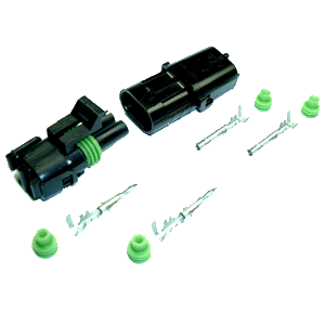

If you can't get the plug fixed well enough, the other option is the cut both plug ends off and put fresh connectors on. It's just 2 wires. You could use simple automotive wire connectors, or you could use something like a Weather Pack connector. That's an OEM quality connector that you can spec to do whatever you need it to do. I used them on my last cobra.
https://www.waytekwire.com/products/...ck-Connectors/
