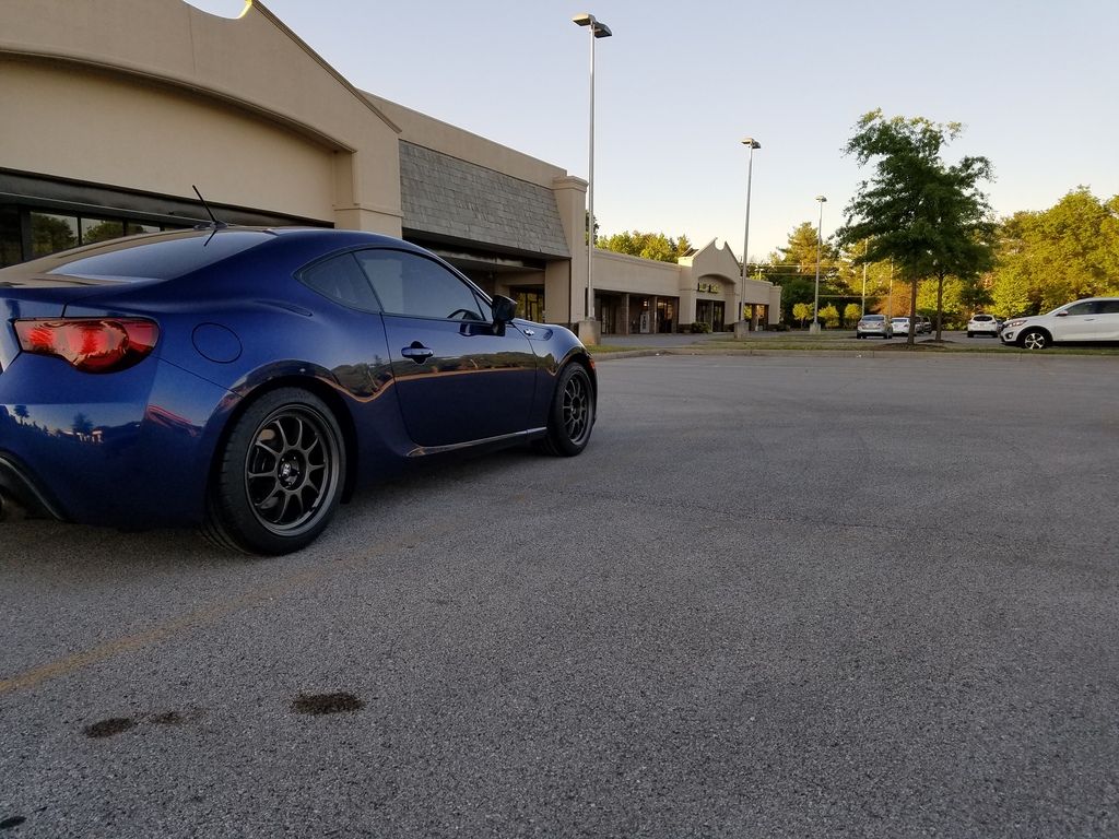

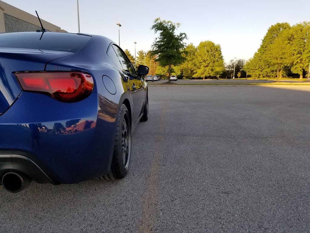

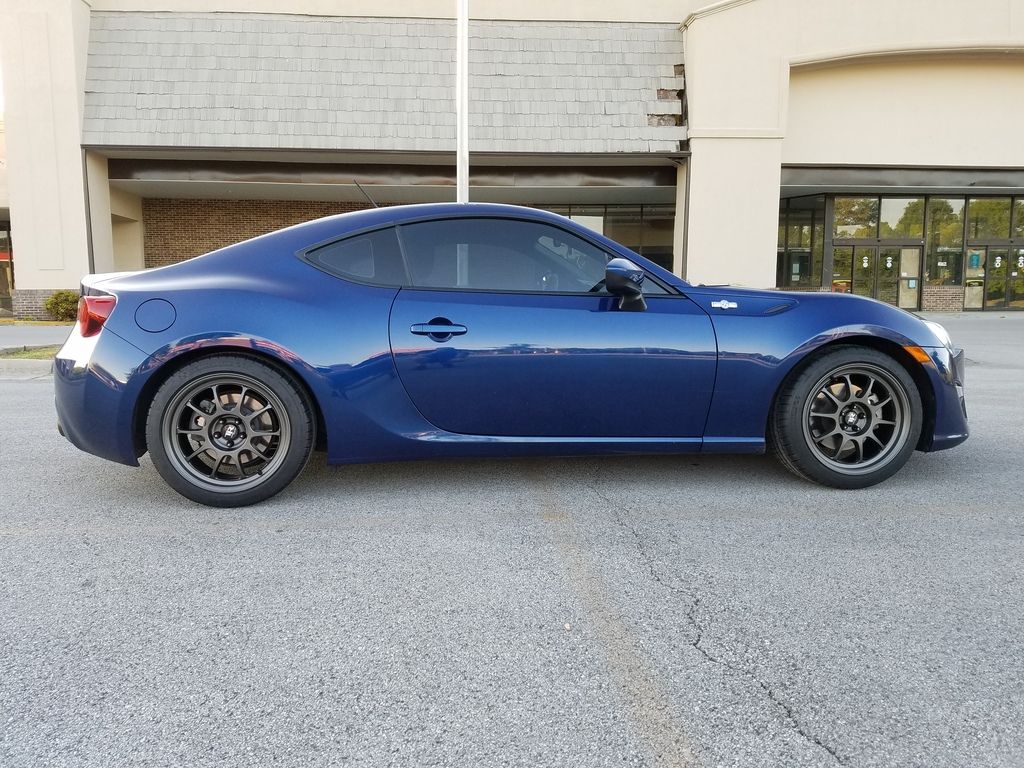

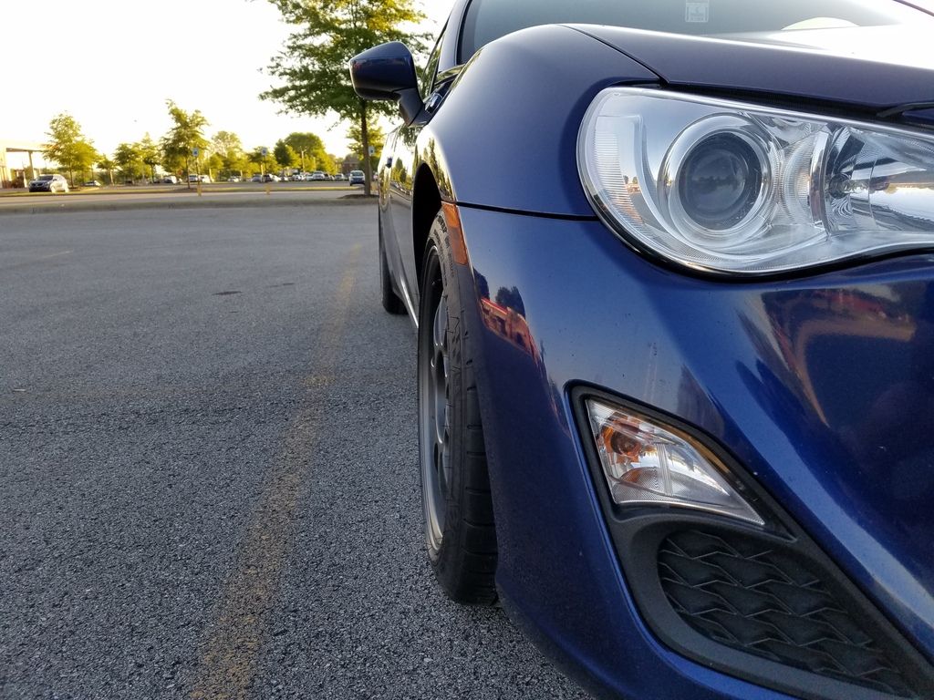

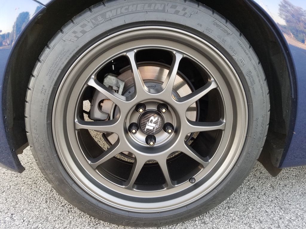

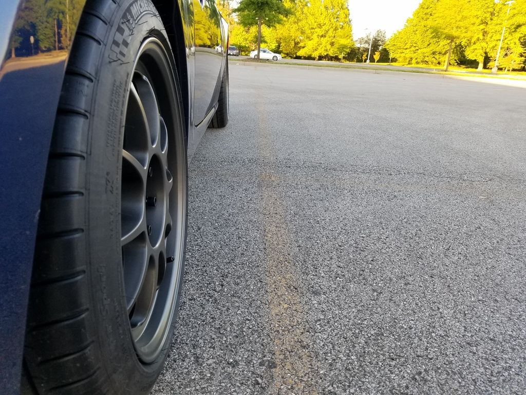

TRMotorsport FF10 17x9 +45mm wheels
I bought a set and I think they look good. I didn't see any pictures of these wheels, so I took a few for people contemplating these.
The weight was 1.76 lbs more than the stock setup, per wheel. This is with brand new 245/40/17 Michelin PSS vs stock Primacy with about 10K on them. So new vs new difference should be even less.
5mm spacers, -3.3 camber front, -2.2 in the back.

I like it. All business.

Very nice!

Looks pretty butch with the 17x9's.
