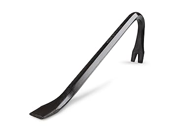

Okay, issue #1. The pads develop a ridge toward the hub and make removal of the pads a bit difficult. I have to pry them out. The outward facing pad I can generally use my fingers to start pushing it outof the caliper. The inside pad I have to use a small wrench to lever against the hub and start pushing it out.
The red area is where the ridge develops. The green area is where once I have started to move the pad out of the caliper I have to pry with the edge of a 12" pry bar.

I have to take a worn out pad/backing plate and my pry bar and pry with all my strength to depress the pistons.
In the picture the black line is the brake rotor, the red line is the worn out pad/backing plate. I put my pry bar in between and pry with all my strength to get the piston to depress.
