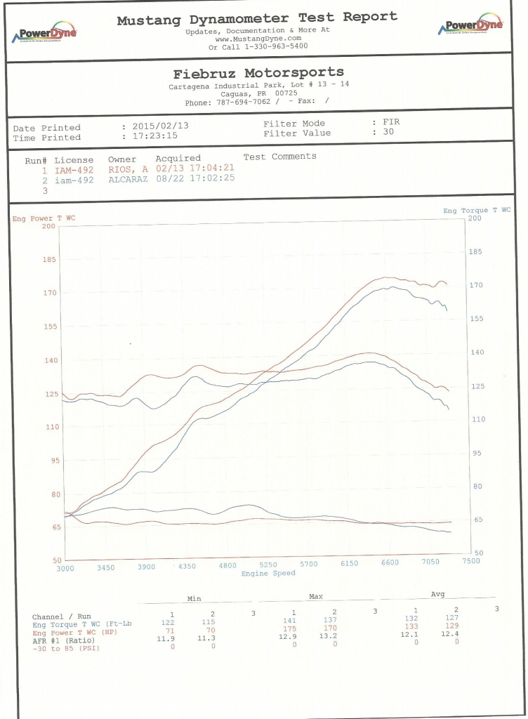

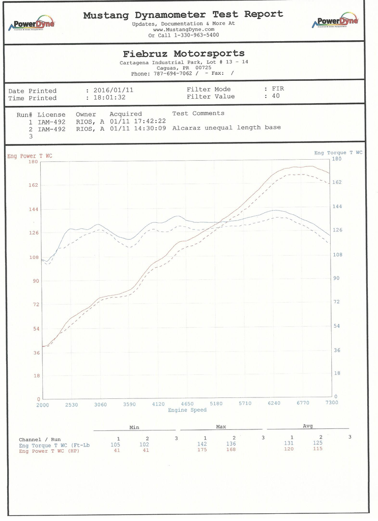

the UEL reduced to the huge torque dip to a little dip. I made 190rwhp on 93oct and 216 on E85 with a huge gain where that tq dip is. And it sounds like a Subaru.
I almost went ft86 but some of the locals had the JDL and it sounded so good.
Both sound great, JDL has a bit more agressive rumble, due to the more unequal setup... and both produce similar power, at least on my car.
JDL tuned
FT86Speedfactory uncatted and tuned
