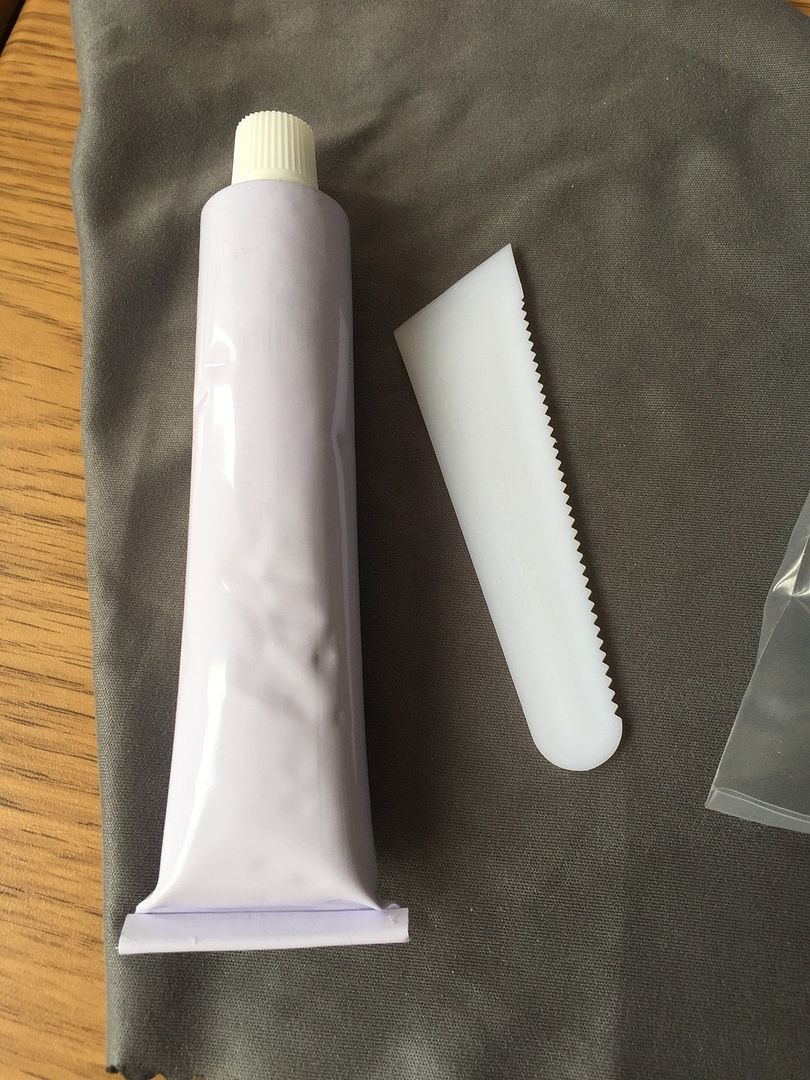

so i just purchased an ebay TRD style spoiler for my raven black FRS. I got it from here.
http://www.ebay.com/itm/201249062728...%3AMEBIDX%3AIT
However, upon receiving my package, i noticed the spoiler does not i have double sided tape attached, it is simply just a spoiler and they gave me a packet of what seems to be some fluid. How would I go about attaching this? Any help appreciated, thanks.

I used 3M tape to stick it on. Make sure to clean both the trunk and spoiler with isopropyl alcohol and take your time in lining it up. That liquid is a sealant I believe. I used it to seal off the contact point of the trunk and spoiler with the provided tool to get into the tight areas. Hope that helps!

is the liquid sealant required? I'd prefer not stripping paint if i ever find myself wanting to remove the spoiler. does the 3M tape have to be applied on all surfaces that make contact with the trunk? Or just certain areas?

I used the sealant because I had issues with my previous car with water and dirt getting in there and lifted some of the tape. I put 3M tape around the perimeter where it made contact and I can tell you its super solid. I close my trunk with it sometimes.

That is body silicone. I didn't bother with it. No issues whatsoever. Just got some 3m double sided tape and some adhesion promoter sponges and went to town.

how would you go about applying the sealant? I have 3M tape in hand already.

Just apply it using your finger to push into the gap then the tool to push it in and remove the excess. The sharper pointed edge was what I used to make sure the sealant went deep enough. Then I wiped it down with a damp towel and soap to make sure I got it all off as I went. It'll be pretty messy if you don't. You'll be able to see where you did and didn't seal it correctly.
