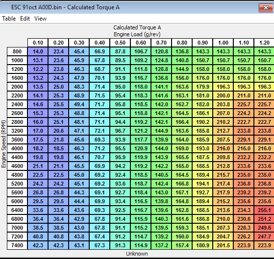

If you have a way to edit your ECU, as in Ecutek, BRZedit, Tactrix, or OFT, you can open the Drive By Wire section, and edit the Calculated Torque tables to affect the TCU. I've just started trying to understand the TCU logic by modifying the A and B tables. I started simply by shifting all the columns one column to the left, saving it, and calling it +10. Then, starting from the same original file, shifting all the columns one column to the right, saving it, and calling it -10. Now I have 3 tunes I can compare, +10, original, and -10.
I thought that telling the TCU I had more power would cause it to shift later, and firmer. Absolutely, positively, not true. The TCU is programmed to shift sooner under heavier loads. It short-shifted so bad my wife didn't like it. The original was a bit better than +10, but -10 was better yet. I still don't know how far I can take it, but I might have to tell the TCU that the engine never makes over 100HP till it exceeds 1.2 load, or 5000 RPMs.
I've gone a lot farther than my -10 table. So far, I'm just making the A and B tables the same, but I think one of them is for sport mode or something. Here's some pics of my latest table, versus the original table.
