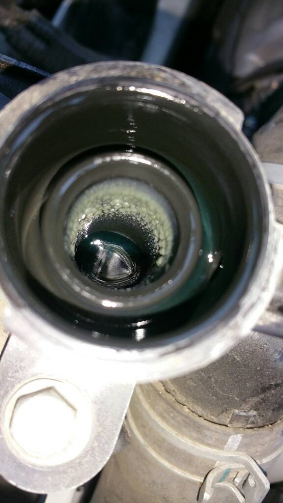

Dots in coolant(open radiator cap)
Size:  56.0 KB has anyone had this yet in there Frs

It's buildup from you letting the system go dry.

Mavs got it right, you should probably flush the coolant and replace with OEM or go the evans waterless coolant route.

So it's normal? So I should just regularly check to make sure the coolant levels are good and the aliens will go away lol

In my experience the dots are from
  • Low coolant (check it more often!)
  • Mixing different colants
  • water that is contaminated (such as rich in minerals)
  • Coolant that is a bit worn down or picked up debris from radiator
I would do a coolant flush (aka radiator flush) and every time I would add water, id make sure it was distilled.
Do you drive your car often? Maybe it's just settled debris.

It may just be buildup at the top of the water neck. Just make sure that 1) your radiator cap is working properly (spring is not stuck), and 2) your overflow tank is not dry.
Minor buildup is not an issue, but over time it will slowly reduce the efficiency of your cooling system.
And as others have said, whatever you do don't just fill it with tap water.
-alex

Check it every other week. Check radiator cap and also reservoir.
Don't forget to pressure check tires monthly, oil weekly (imo) and just do a simple walk around your car.

Have the same, wiped it out, will flush at 60k miles which should be about 4-5 years of ownerships, nice to know it was from the time my reservoir was dry.

The over flow tank was left dry by the dealer I took it too! Fml I trusted them
