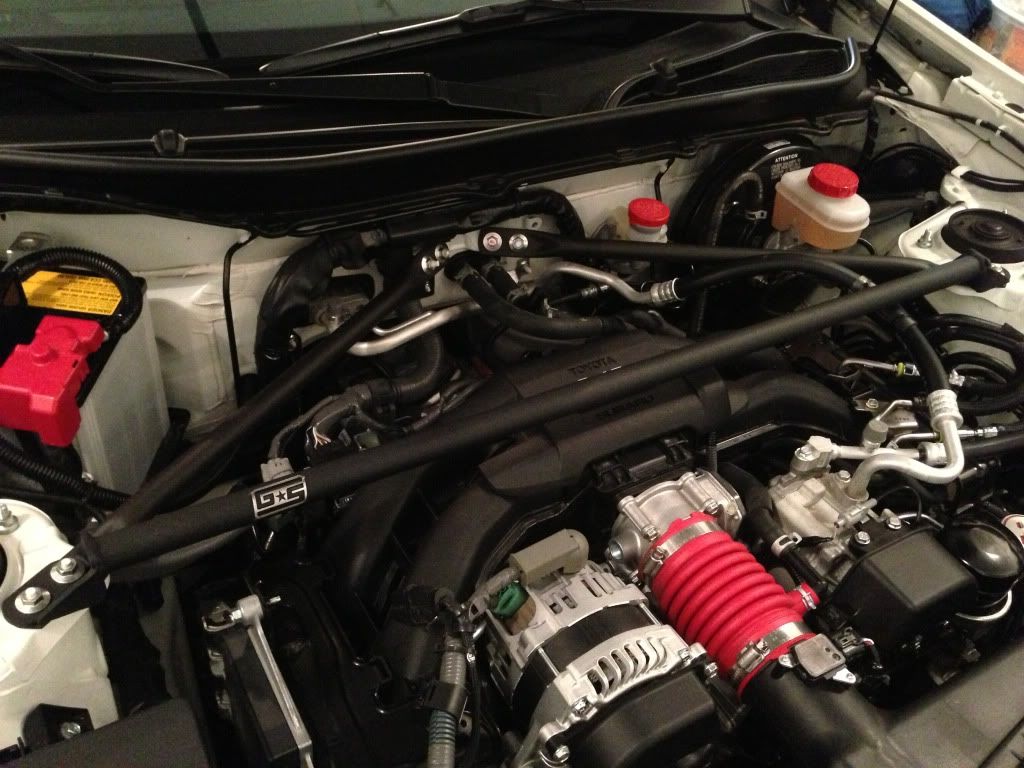

Check out my solution for the AC line chaffing. Some may say it's overkill, but "overkill" is my middle name...
So I borrowed your ideas of hose clamp and mounting point. I had planned to utilize your setup, even have the $5 rubber thing from HK, but then I came up with a design of my own and thought I'd share. Any constructive criticism welcome. And yes I quoted pictures for easier comparison.
Main difference here is a spring extension; 1/2"x2-5/16"x.062" (12.70mmx58.74mmx1.60mm)
And oh yes, installed bar:
xn7485 is offline   Reply With Quote
Looks like that will work nicely. I actually contemplated using a spring in my initial design. Allows the line to move freely when the engine rocks. Cool to see other people's concepts...
