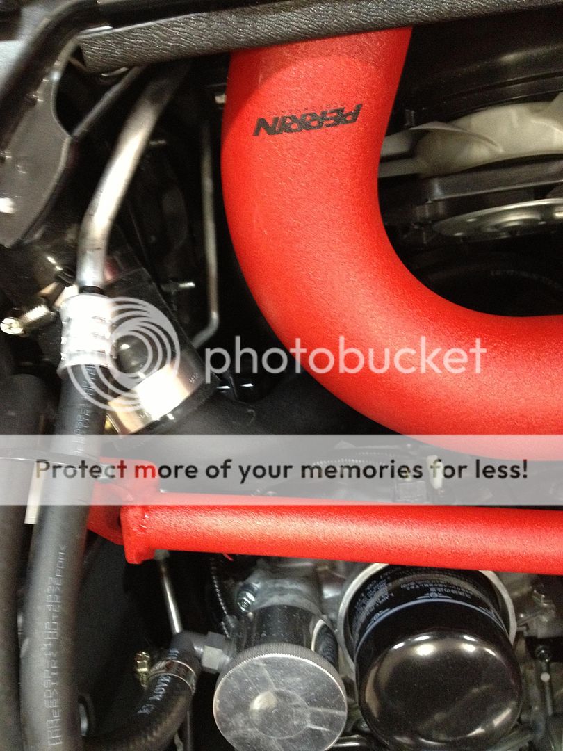

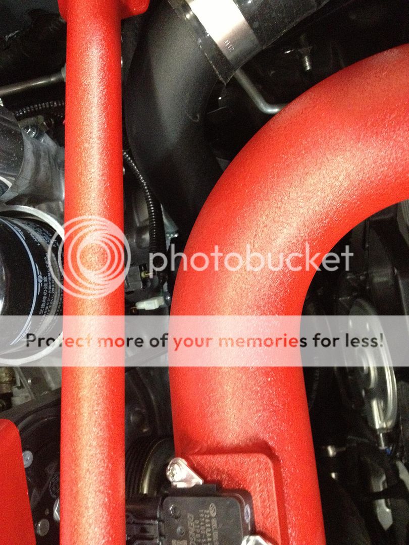

Originally Posted by Slartibartfast View Post
Is there anyone in the group buy getting the red brace, who already has the red Perrin intake?
Cheers all!
Here you go. I just quickly took a pic with it laying next to the intake. Looks to be a perfect match to me. I will have a few installed pics tomorrow. I have also painted a few other pieces, as well as the other 2 stock braces with engine enamel, and they all match. The enamel is just slightly darker, but not a real noticeable difference unless your looking real close. Biggest difference is that the perrin and grimmspeed pieces have the wrinkle finish.

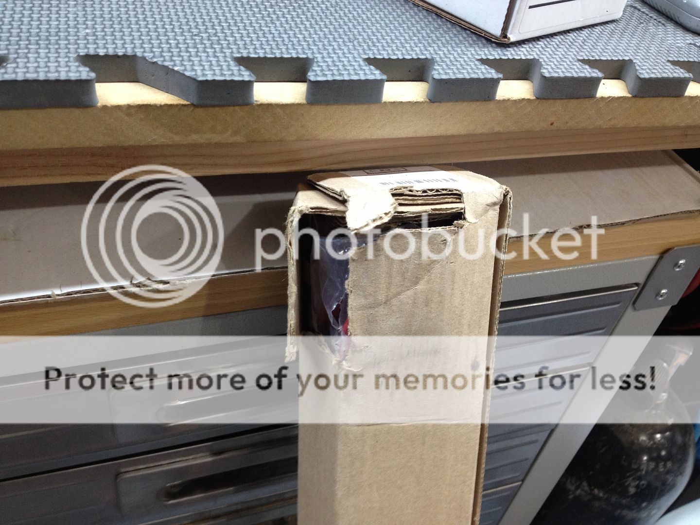

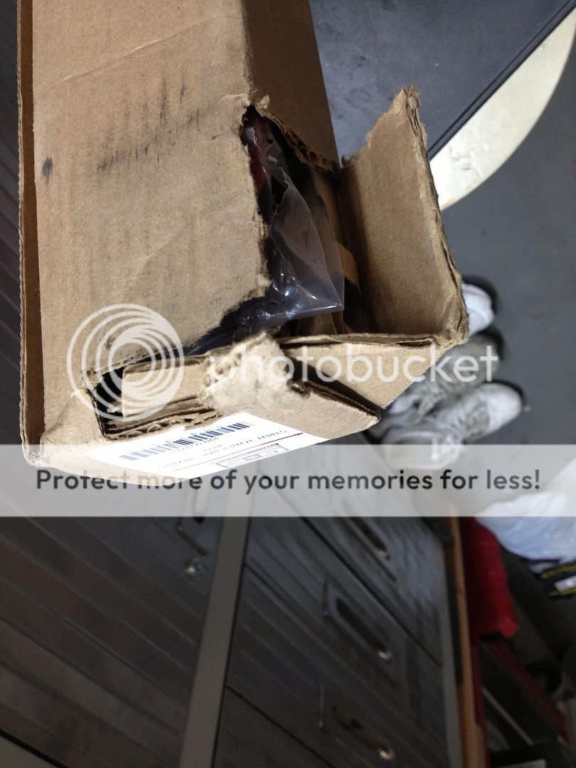

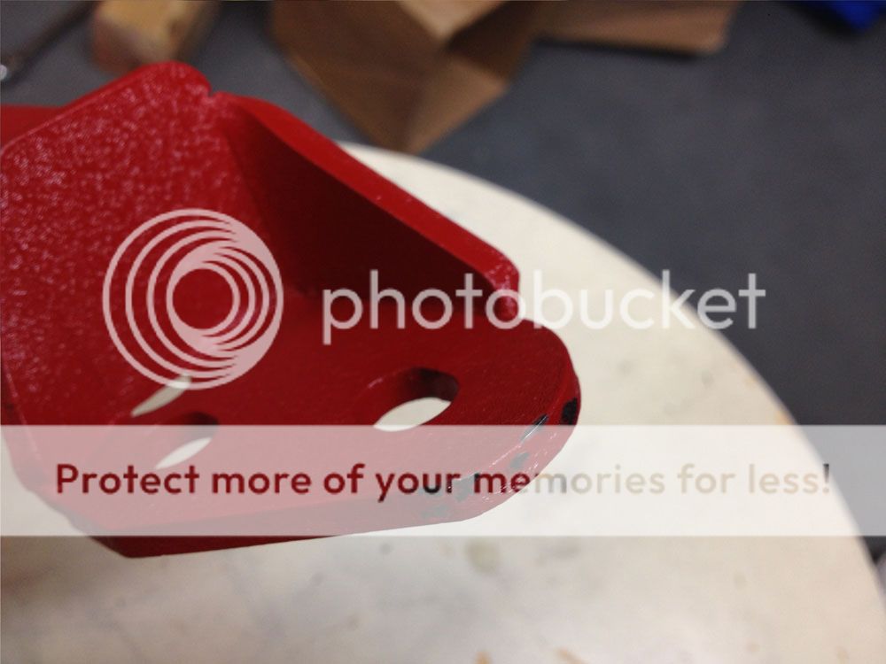

Shipping Damage
Also, as someone else noted. Mine came shipped in bad shape, one whole end of the packaging was busted open and the paint was all chipped off on that end. The whole bar was sliding in and out of the box, the packaging probably should be a bit better. I have emailed Grimmspeed about it, and hope they can do something about it. Right now will have to touch it up, hopefully they can ship a new one out, or send touch up paint, not sure how noticeable it will be, i am going to do a test fit and see how bad it bothers me....
