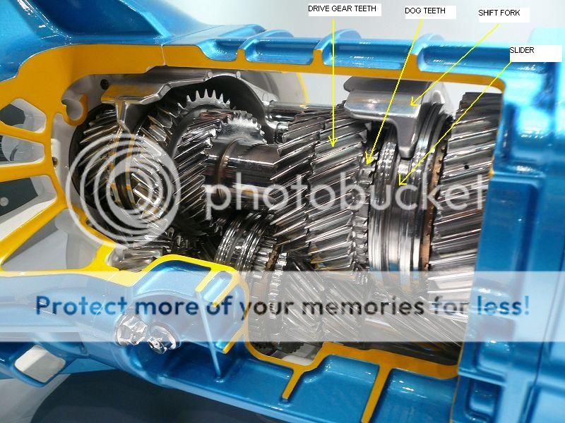

Originally Posted by D K View Post
Our cars have dogs?
Originally Posted by OkieSnuffBox View Post
Dog rings in the transmission.
Originally Posted by 7thgear View Post
which we don't have.......
Dog TEETH!
And yes we have dog teeth in our trans.

Dog TEETH!
(Dundee)you call those teeth?(/Dundee)
Those look more like the teeth of a Herbivore.....
Hippos don't play around, mang.
