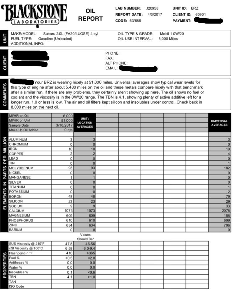

Old 07-21-2017, 11:30 AM   #107

Originally Posted by JMon85 View Post
Works for me!!! But mine is DD only.
Ernest72 is offline   Reply With Quote

Mobil1 seems to work fine, based on my last UOA.

Good to know!! I'm currently running Mobil 1 0W/20 as well, no issues. But this time around I'm going to switch to the Subaru oil because ...
