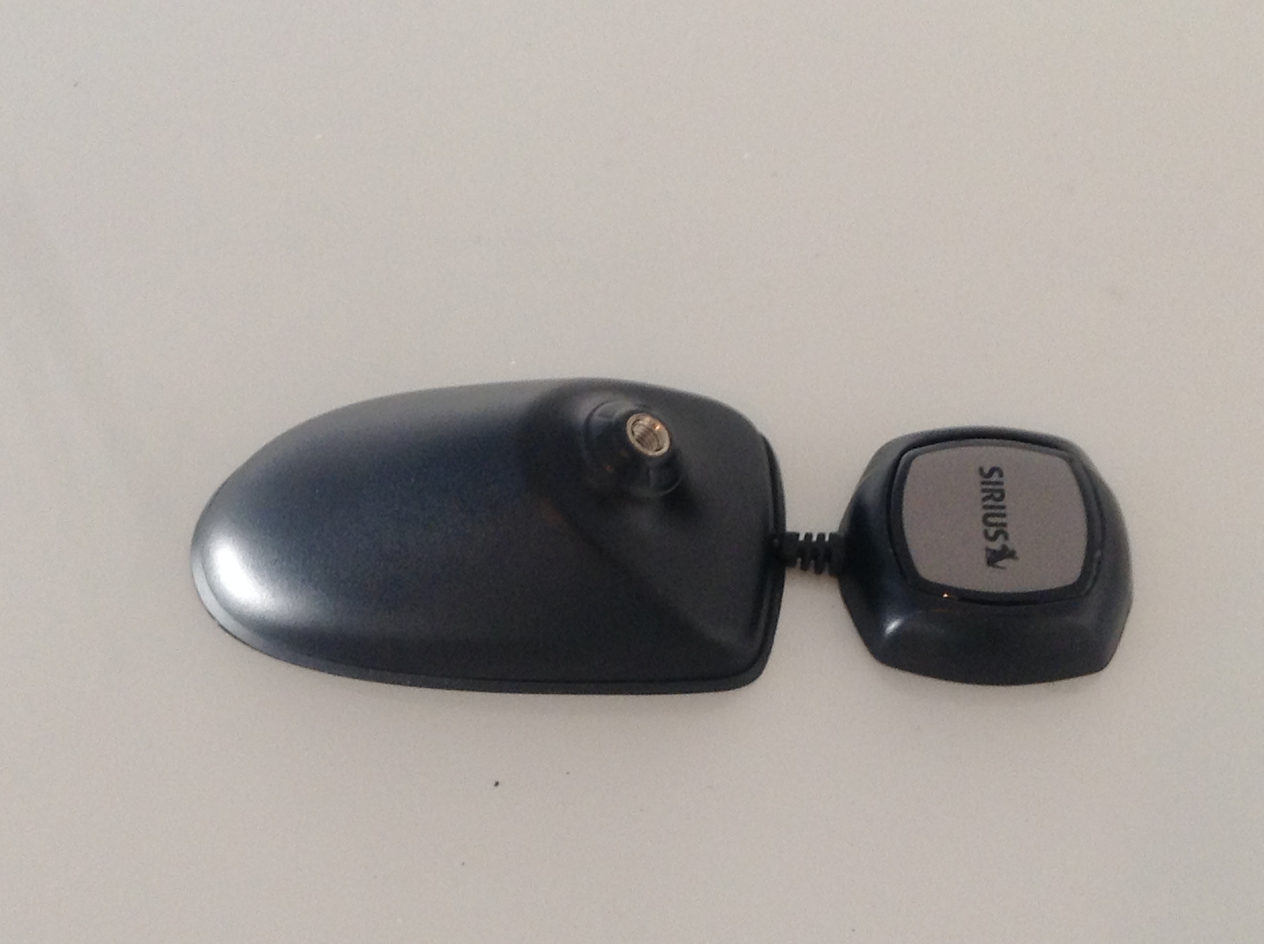

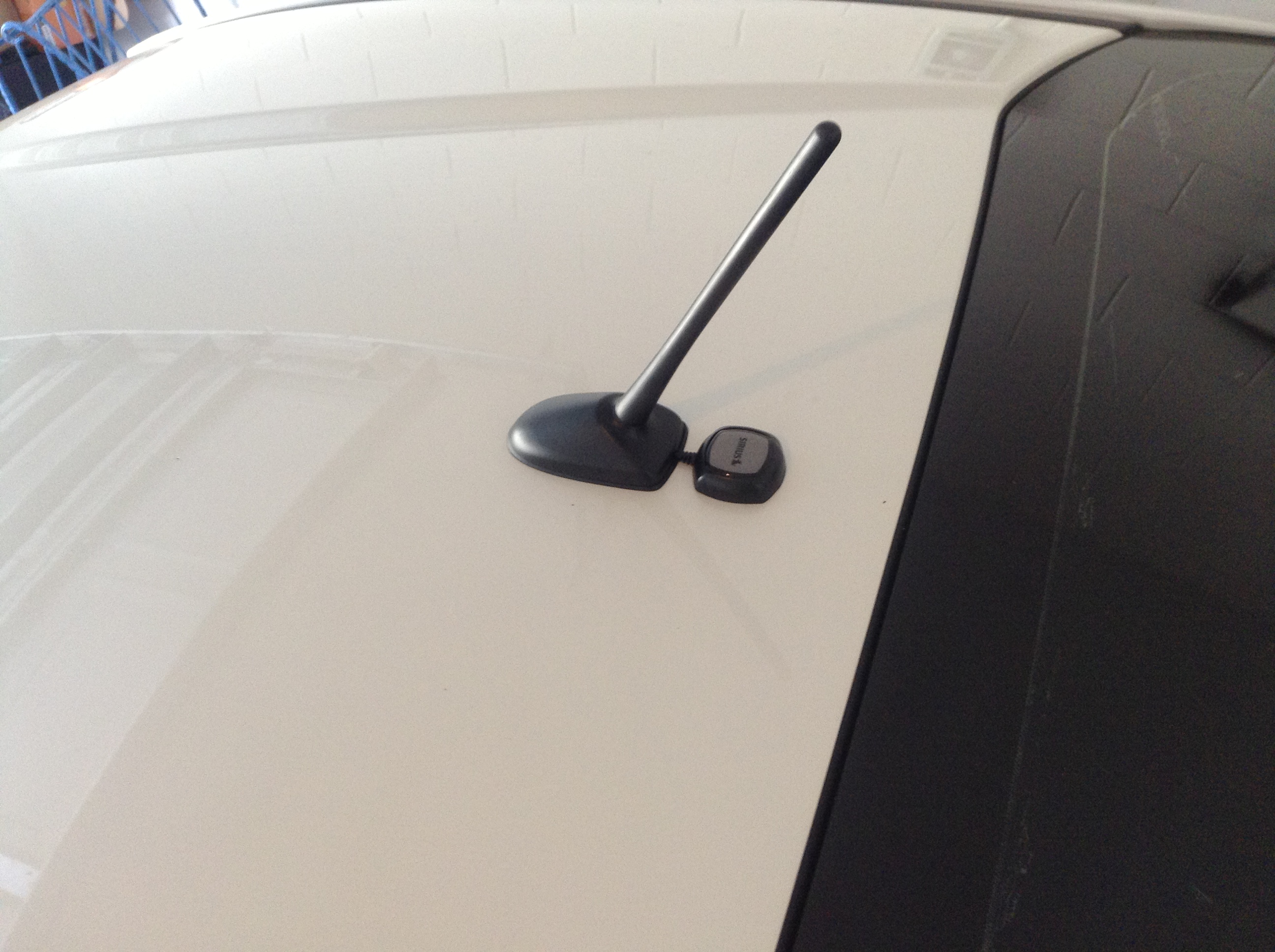

There has been a lot of confusion on whether or not we can get satellite with a Sirius subscription (NOT XM) through the stock FRS head unit. Well, I just finished installing Sirius satellite radio on my FRS today. To be clear, I have a lifetime subscription with Sirius, NOT XM. I also have the basic Panasonic head unit (I don't know if this would work with the BESpoke HU). I did exactly what this guy posted over at fr_sforum.com (link), and it worked perfectly. I had to call Sirius to switch over my lifetime sub to the new radio, and they said it was the last time I could transfer it to a new radio, and charged me 75 bucks. But whatever, should be good for the next ten years.
Finally, for the Antennae, I wired it through the hole in the roof for the radio antenna following the instructions in this thread:
http://www.ft86club.com/forums/showt...sirius+install
Here are some pics of how that looks:

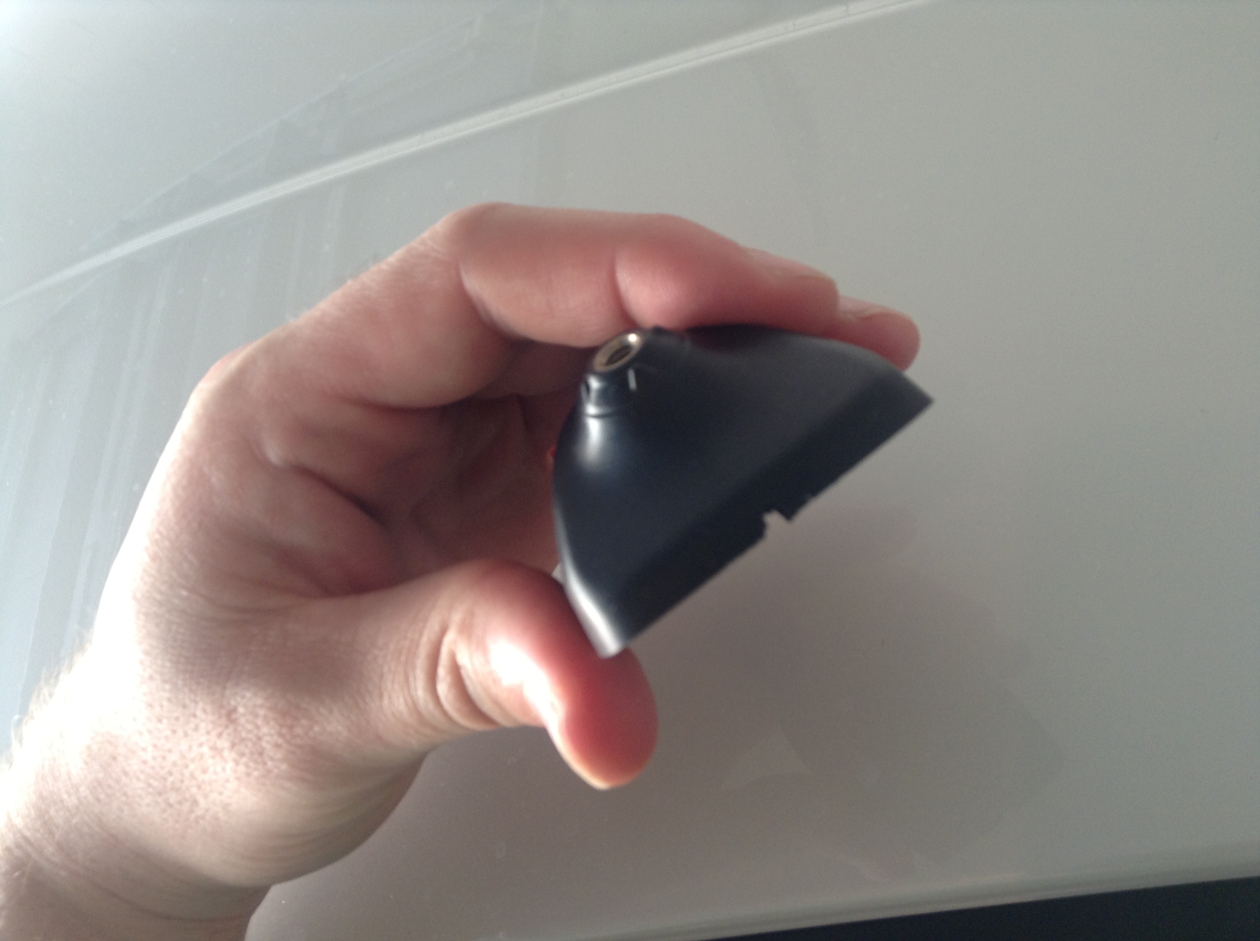

When you loosen the bolt holding the stock antennae from underneath, and lift it out, there are two screws underneath. If you remove those screws and remove the cover, you can thread the wire past the rubber molding to get it through the hole
You have to cut the top of the rubber down a bit to make room for the wire coming out the back, and I cut a small groove in the plastic cover so it fits properly.
Once you pass the wire through the roof, thread it through the bolt which holds the antenna to the roof (there was a yellow plastic clip in the bolt, the plug of the antenna didn't fit through it so I removed it, but the bolt still seems to fit just fine without it).

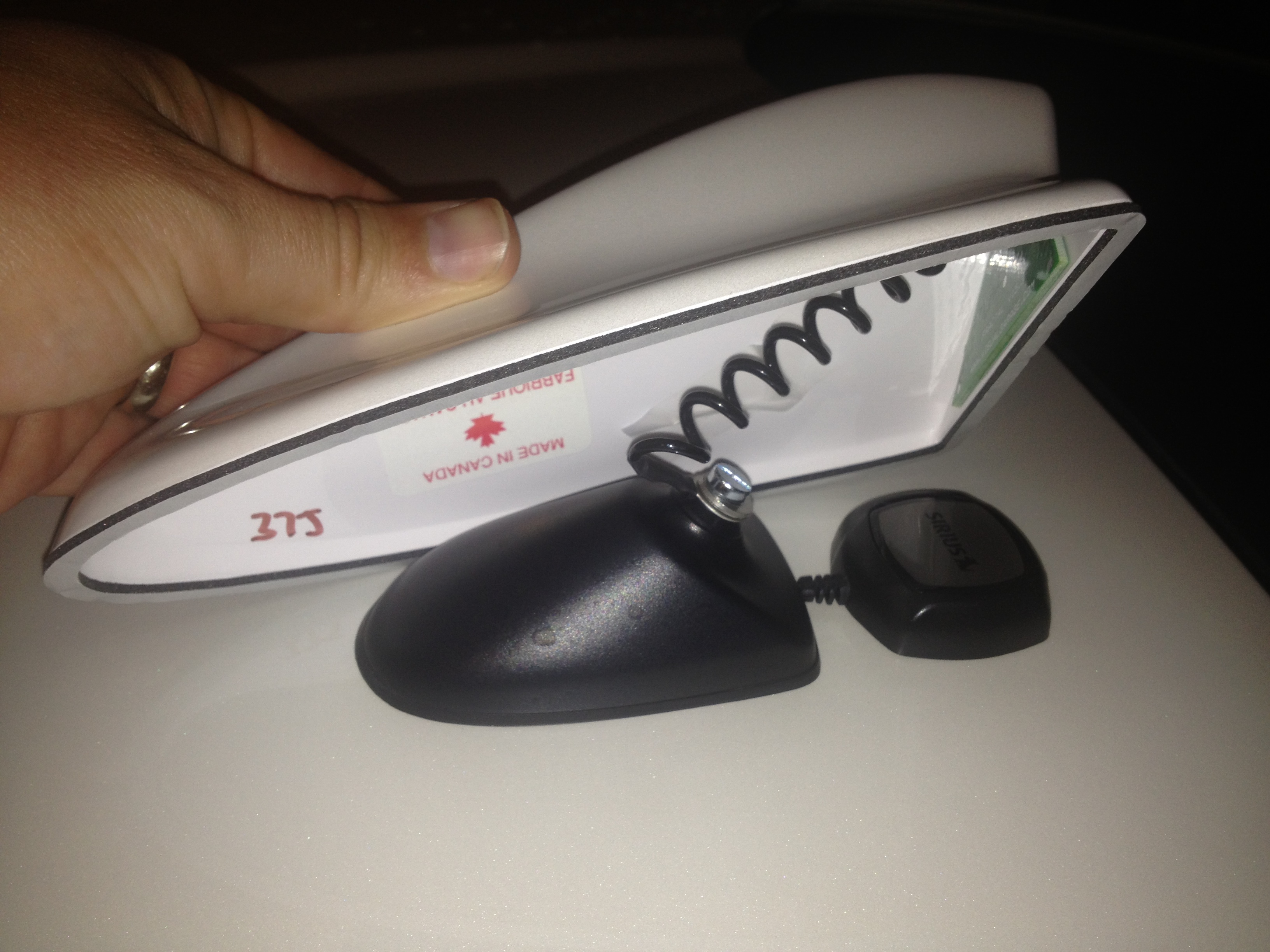

I think this will all fit under a VG shark fin. I'll update once I get mine.

Sirius antenna fits under VG shark fin.
Finally got my VG shark fin. Satellite antenna fits perfectly.

Did you contact VG to get the right fin? The web page doesn't list the FR-S when you go in to order. I'd like to do this mod with the XM, but having seen the Beat-sonic fin I'm not sure that would cover it like the VG.
Got mine through the second group buy on this forum. They are doing a third if you are interested, took a little while together it, but I am very happy with how it turned out. http://www.ft86club.com/forums/showthread.php?t=31309
