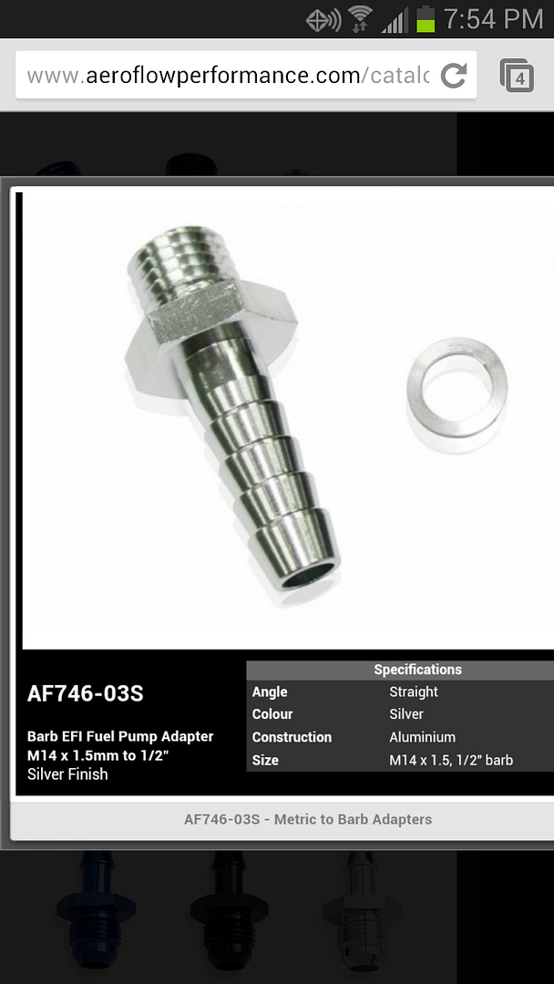

Alright, this is what I found for the coolant plug fitting.
Its a 14mm 1.5 thread pitch plug. I have an adapter from that to NPT to a 1/2" hose.
(The plug is on the left)

Found another fitting that might work:
