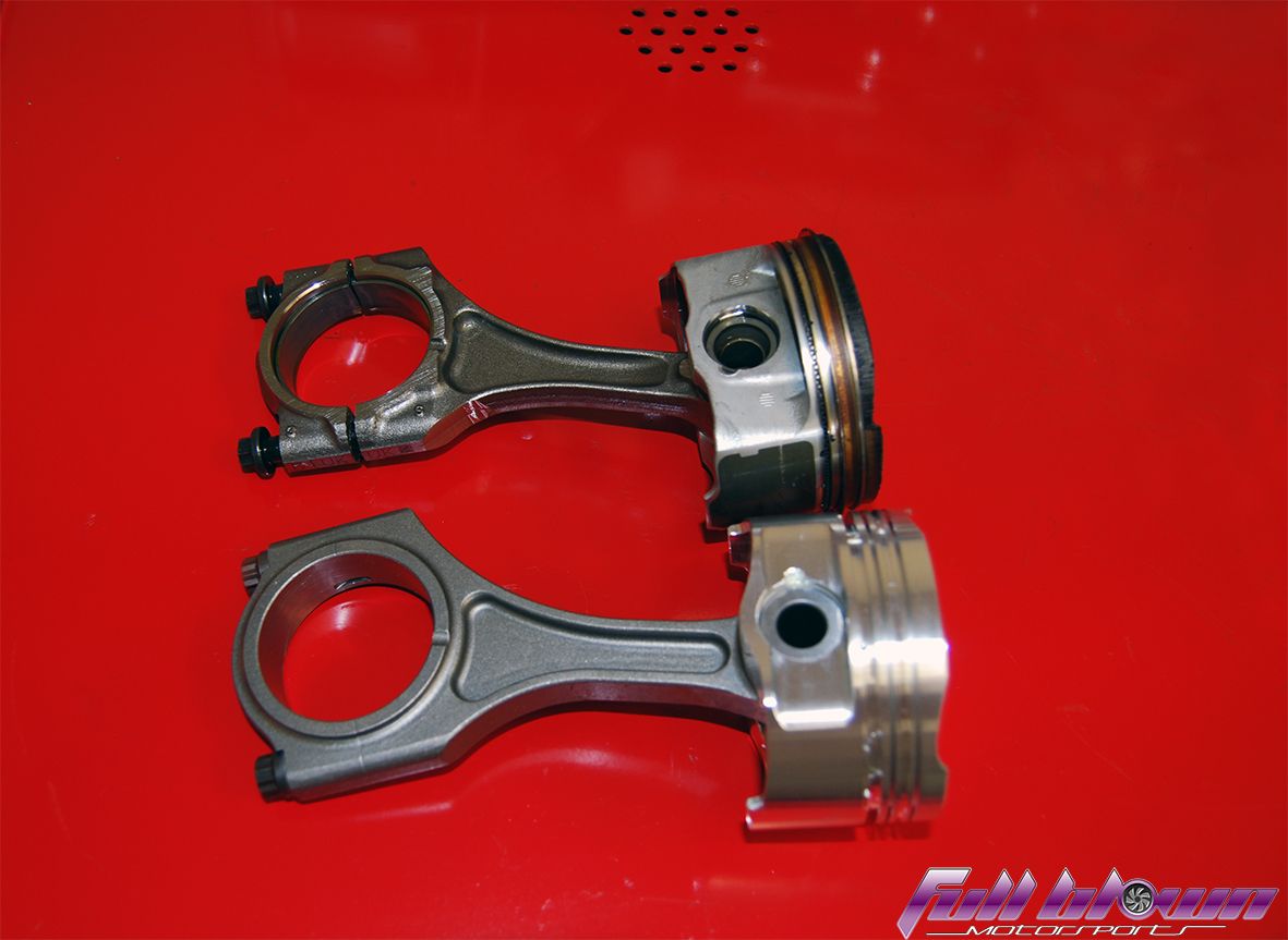

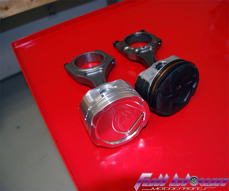

We received more Arias/FBM Custom pistons in stock with upgraded wrist pins. You can see in the photo of the standard duty pin versus our upgraded pin.
Our pistons are designed to handle 30+ psi of boost with larger rings, skirts as well as other advantages over most off the shelf piston.

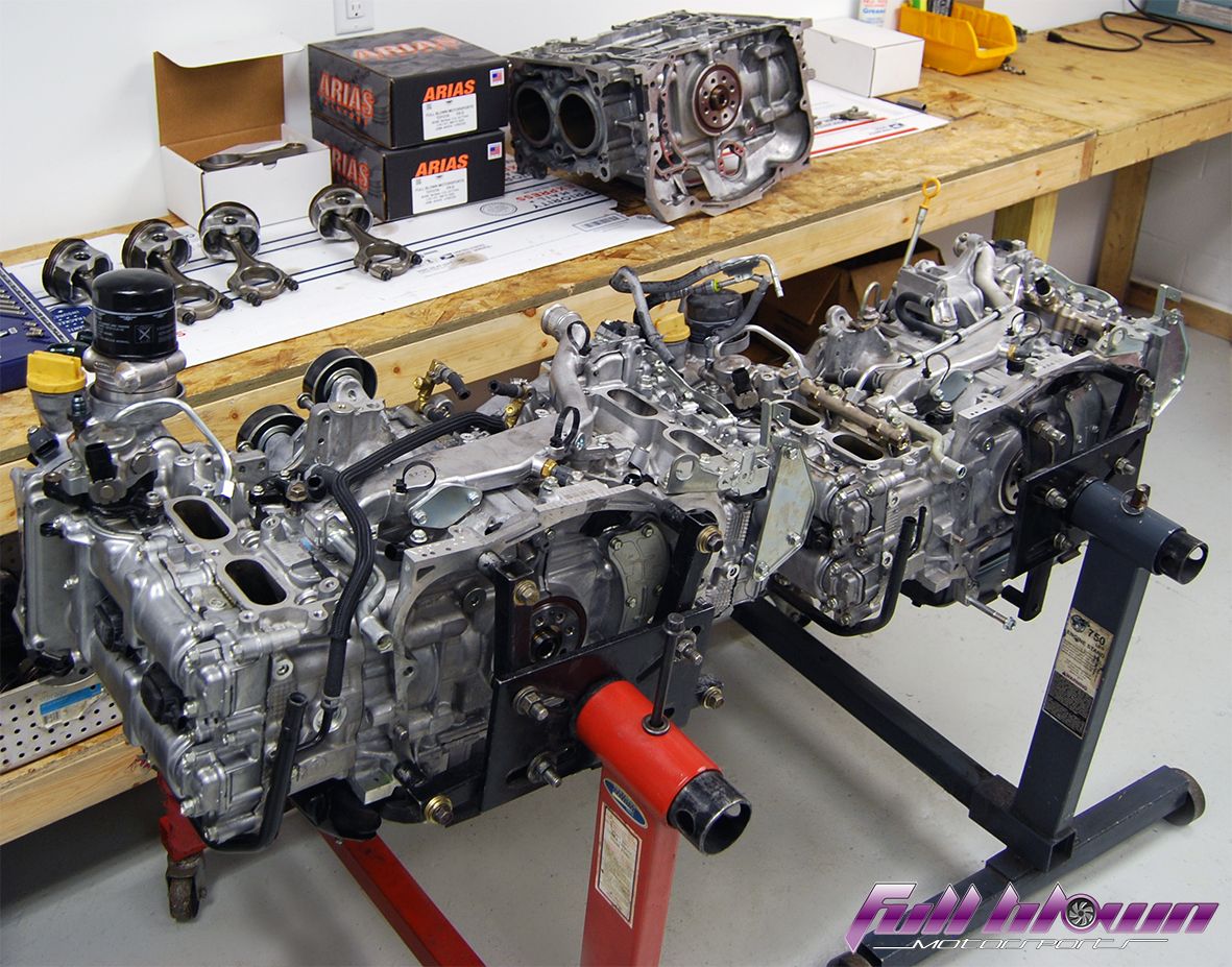

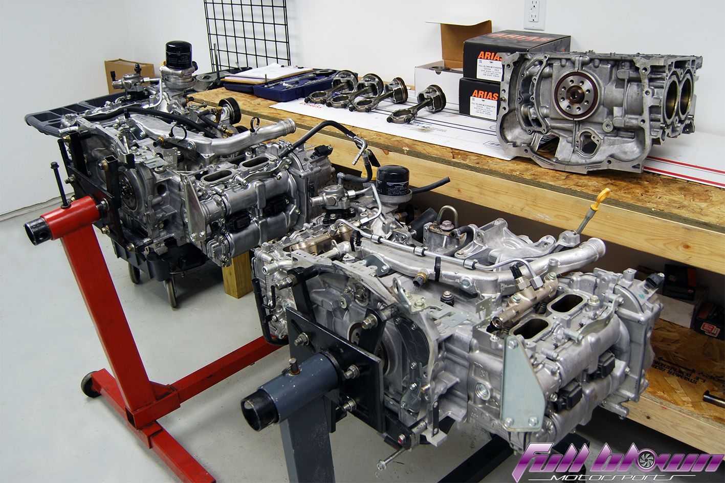

You know the season is around the corner when there are motors to be built. We have built many FA20 motors and looking forward to doing more this coming season.

Haha, that room is the warmest part of the whole shop. I don't think he minds being in there.
Our engine building room is climate controlled to make sure all clearances are checked at room temp.
