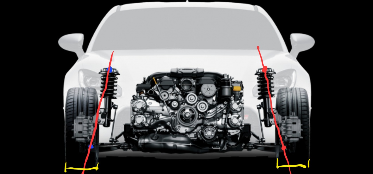

No sure where to post this. But I was wondering whether the stock gr86 brz has pos or neg scrub radius. Maybe I reading too much into a marketing photo. But it does look slightly positive.
I am interested cos I wanna put my et42 tc105n onto the gr86 brz but dun want to f up the scrub radius ie steering feel and kickback (which I like hahah). worst is if it is slightly neg and the et42 offset ie 6mm more poke causes the scrub radius to become zero.
